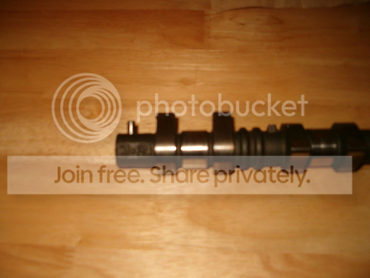

Ok, I snapped a couple pics last night. Its really simple to do - drill a hole behind the magnet in your intake cam like so:
Tap the magnet out with a hammer and punch.

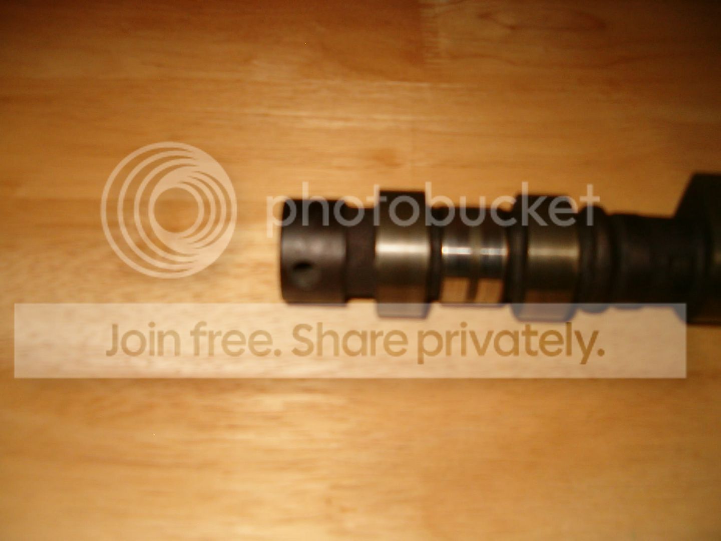

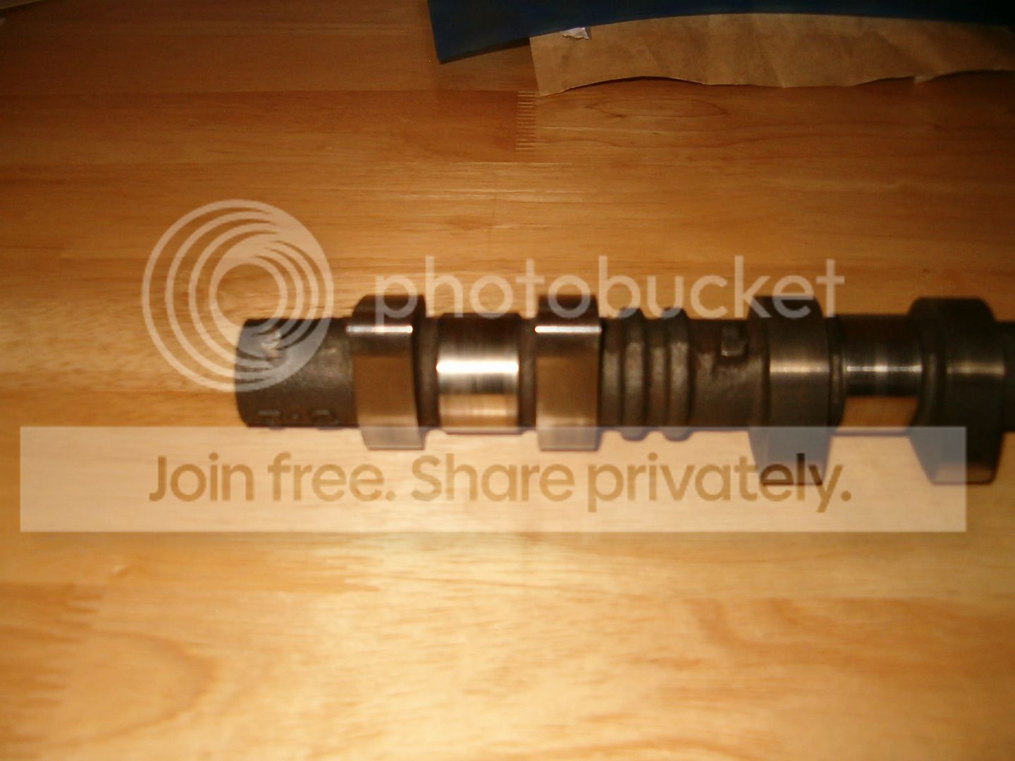

Then, chop the end of your spare 1.8L or 2.0L exhaust cam. I was worried this would be dificult if it was hardened, but it sliced like a piece of cake. Just use a bandsaw or electric hacksaw (or a hand hacksaw if you have a lot of time on your hands). Drill a hole 1/4" that lines up with the last lobe on the cam. (i used a 15/64, but my bit was bent slightly. You want this hole to be tight) Drill all the way through so if you ever need to get the magnet out you can.

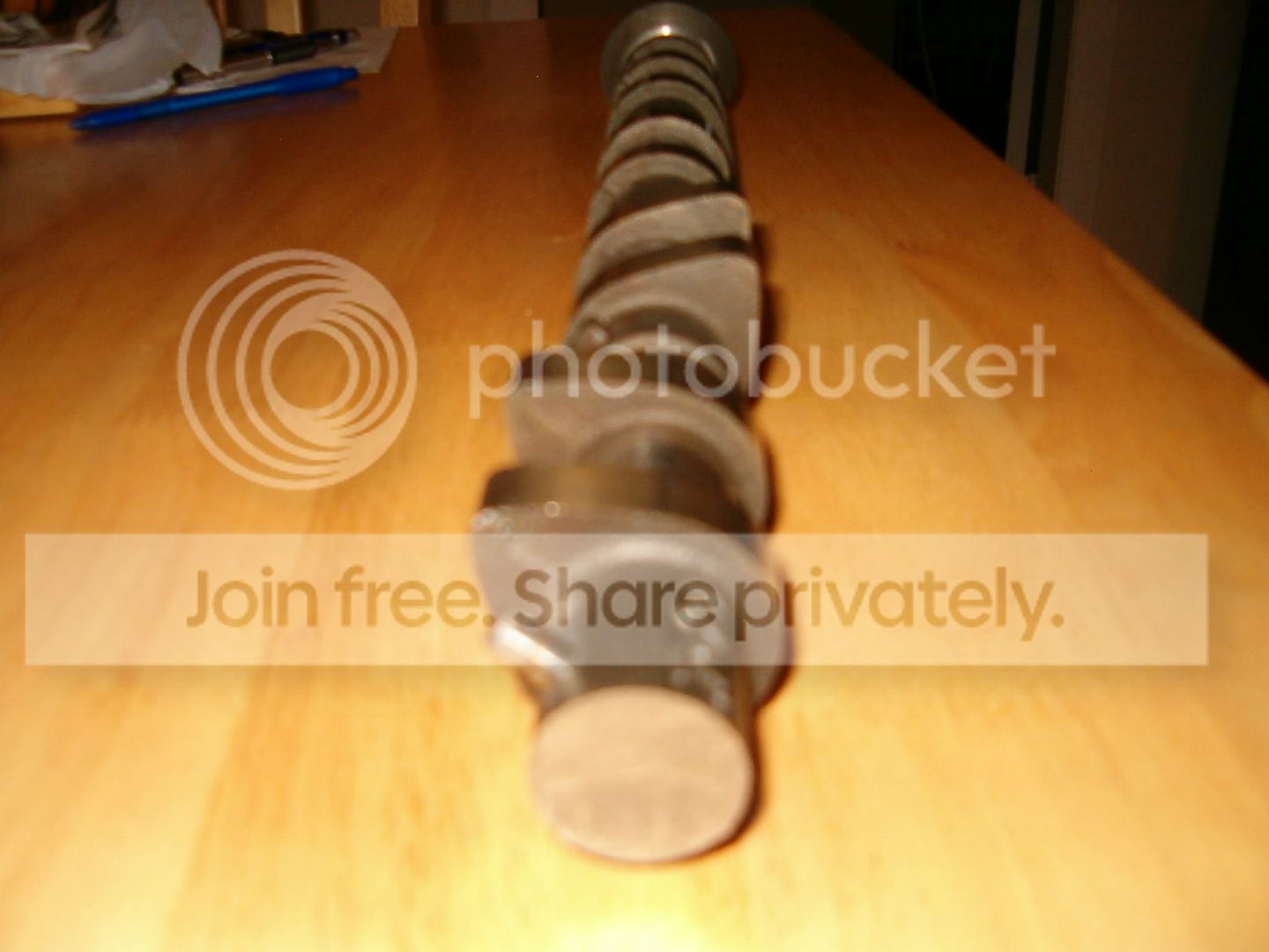

Then just tap the magnet in so it sticks out the right amount. (you measured your intake cam with a caliper when you did this)
sorry for the really bad pictures, I had some good ones but I couldnt find them so I snapped a few quick ones with my wifes digicam.
