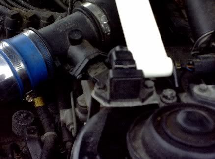

Well I got the code P1605 which reads out to Keep Alive Memory Test Failure. I have no diea what that means but webtech says to check the acceleration sensor. I will do this but where is the sensor? Thanks
Old Aug 31, 2005 | 07:03 PM
that is the sensor on the driver side strut tower.

some people call it the accelerator sensor, others the knock reference sensor...
it's this lil guy click to enlarge

OK I thought that was the one but I was thinking of it as a knock sensor. So tomorrow Ill check it with a multimeter and if I dont get what webtech says I should get should I replace it? Also, I have been having nothing but trouble with my wiring harnesses in the engine and theyve caused me to throw a bunch of CELs and then they go away so should I even bother to replace it if this could be the case?
