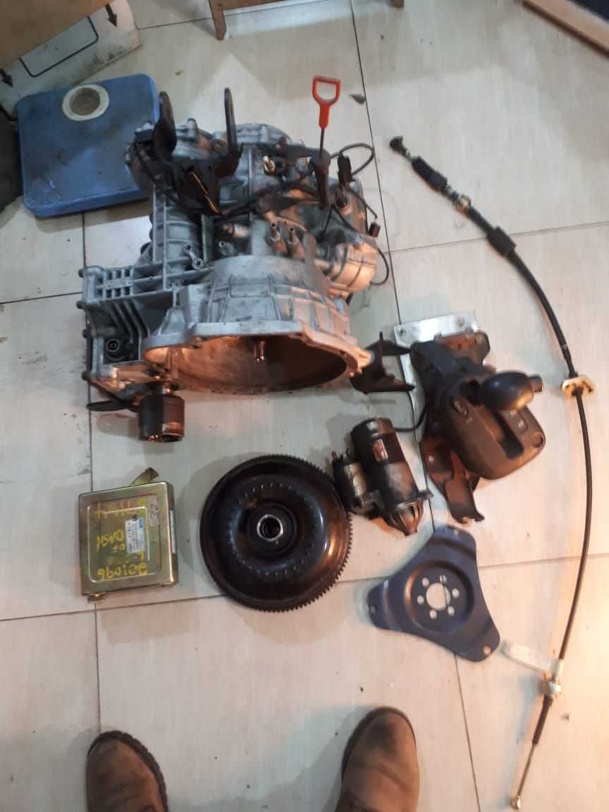

i open a side thread about my project to go to automatic gearbox on my drag car.
i have find and buyed a automatic gearbox fully build buy ipt transmission , apparently same than puerto rican misito la pulga used on his accent .
in my country we are not very familiar with auto , but i was too limited on gear choice , and strengh of my mechanic one , and get custom first and second taller gear would be too expensive than buying this auto gearbox .
so today i receive everything
ipt fully build auto with apprently LSD
ipt high stall torque converter .
but gearbox reference have been removed . can someone telle me wich gearbox is it with the picture .
i'm want to make a manutronic mod like they do on DSM to get total control on the gearbox shift . does anyone have information how to control solenoid and pressure directly on this gearbox ? any information is welcome and i will share my developpement on this project .
will have paddle shifting and arduino like based microcontroller .

for information the project go well , i have found all the information i was looking for and developping a tcu controller based on arduino to control manually gear change like on DSM , and with paddle shifter

What version of the transmision are you using? If you are using the 4 solenoid you can use a programmable TCM from ForcedFour.com,
