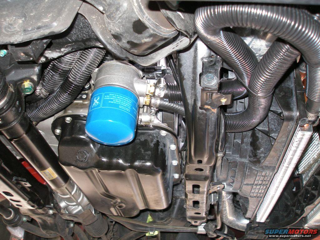

you use a sandwich plate on the oil filter.

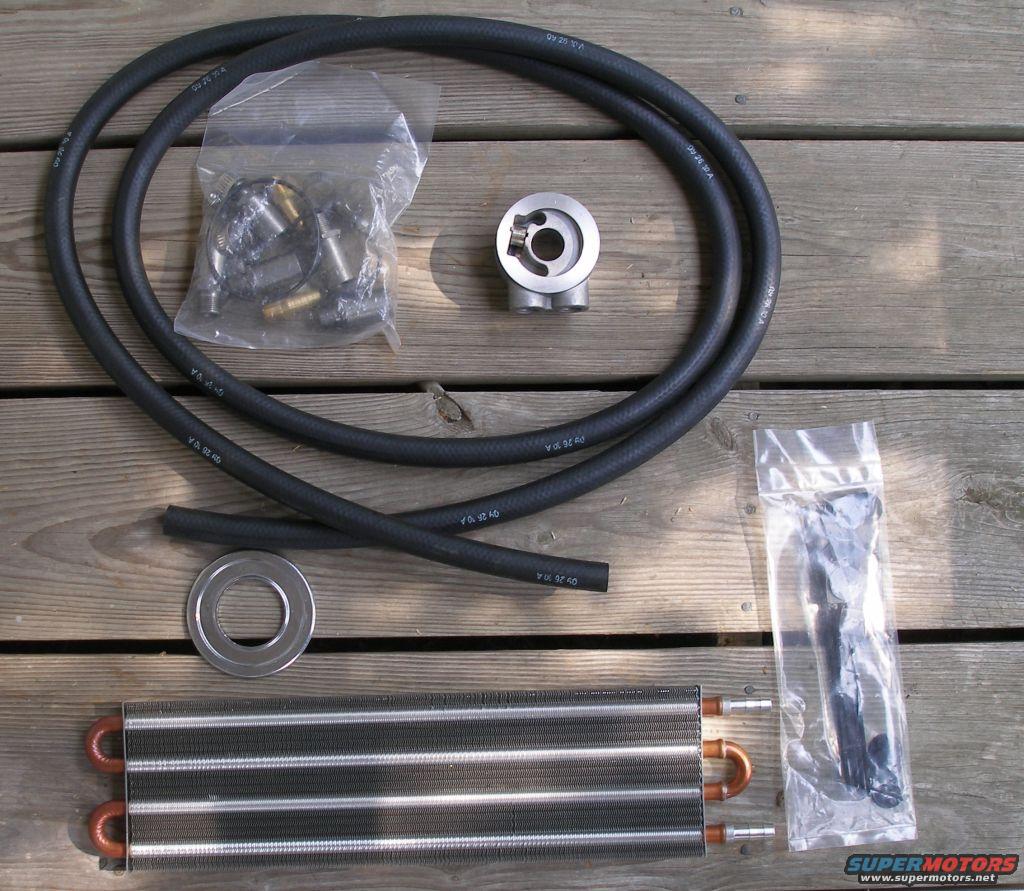

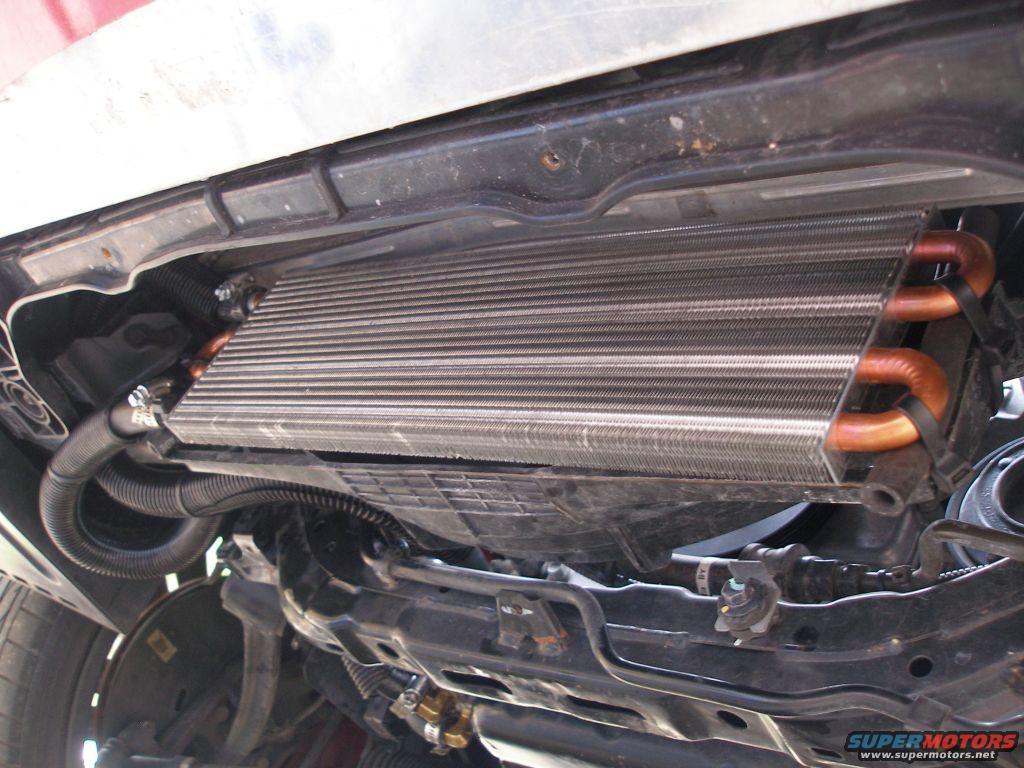

I used a flexalite-3951 kit. Comes with a thermostatic sandwich adapter.
