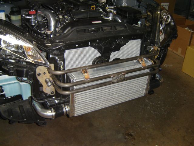

Old Jan 11, 2012 | 04:44 PM
Richardb1285's Avatar
Joined: Sep 2011
Posts: 10
From: Maryland
Vehicle: 2010 genesis coupe
Here is a pic of my intercooler, Due to size I had to ditch the crash bar and actually do some trimming on the back of the bumper.
