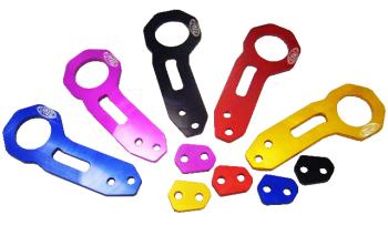

My buddy totalled his civic and gave me his tow hooks. Im trying to figure out how to install them. Any ideas?
Heres some pics of them on other cars

Certain racing leagues require external painted tow hooks. Even when they're not required, like in SnowX, if you stuff into a snow bank, you're much easier to tow out with a big red meta ring sticking out the back of your car.
If you want to install them, find your existing tow hooks and drill to mount the new ones. Easiest way.

as far as installing them, the rear tow hook is connected to the tow hook you already have back there using bolts and the bracket it should come with. as far as the front, you have to drill holes in your front bumper support and screw it in. you will need to cut a slit in the front bumper for it to stick out.
