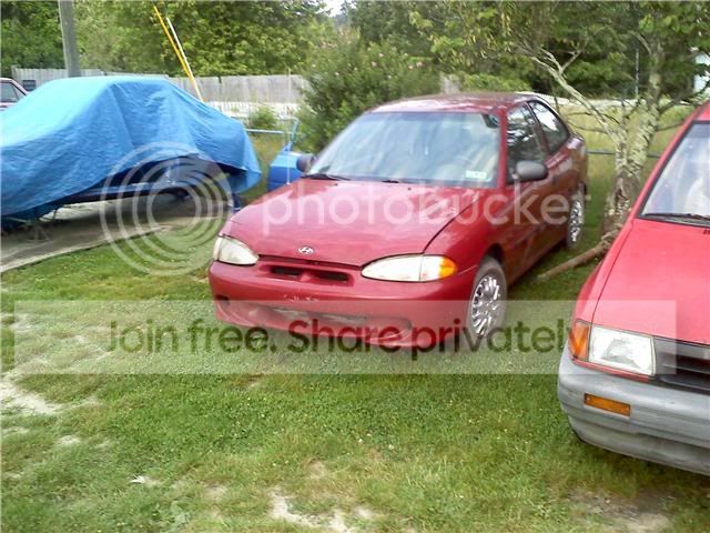

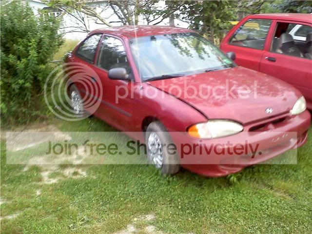

For starters few months I traded my chevy truck for this red 97 accent. I got the car in desent shape. It has a broken door handle and a cracked front clip/bumper. The body has a few minor dents and dings, anyways here are a couple pictures of the car in the state that I got it.

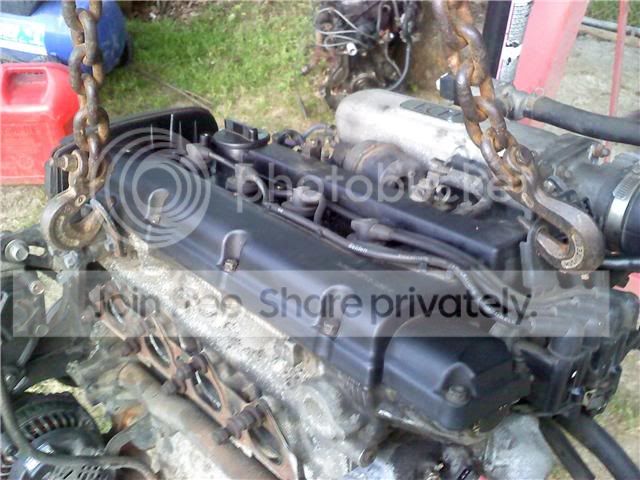

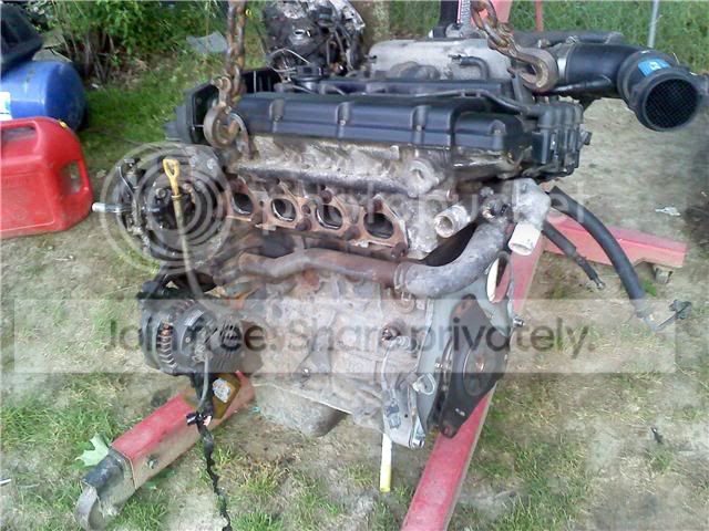

When I got it the stock 1.5 dropped 3 valves. I was going to go ahead and try to fix the head but once I removed the broken valves I noticed the head cracked. Once I noticed that my only 2 other options were to find another 1.5 or just go ahead and find a bigger engine. I ended up finding another engine out of a 97 elantra gls wagon. I was hoping that it would have been a beta 1 2.0l but to my noob knowledge I didnt know that most if not all 1997 wagons had the beta 1 1.8l.
Anyways, here are a couple more pictures of the engine just after pulling it today.
Sorry for the crappy cell phone pictures.
The engine has roughly 68,000 miles. It looks alittle rough right now but its going to clean up real nice. For the time being I am going to clean the car up and start detailing the engine. While im detailing the engine I am going to go through it and do the usual tune up and probably change the timing belt. The car that the engine came from sat for over 5 years so its only wise to do so.
