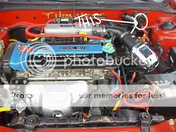

ok i just checked the wipers.. and they dont work
i looked at the fuse panel under the hood and i ddint see any wiper motor relay.. maybe they abbreviated it weird.. or im just tired lol.. so i guess i need to check for voltage at that switch..
is this the one ur talkin about??

Not to be rude, but i cant really say that is or isnt it, sense i am on a Naval Carrier somewhere in the middle of the ocean...
Due to OSPEC they will let me get on the site, but they block pictures. Yet it is very easy to spot, it is a rather odd guy, looks almost like a window motor, it is just to the left of the brake booster if you stand in front of the engine bay looking at the fire wall, the first thing i would do, is just take a DMM if you got one, and see if your getting the tweleve volts, if you are and they still no worky, then that motor has blown.
Pretty simple as long as you have some basic electronic skills, and understanding of how to use the DMM correctly and understand what the reading is telling you, if you arent getting and voltage, you can OHM that line to see if it shorted to the Chassis, put one lead in the power wires place, then simply put the other into the slot of the relay. this will tell you if the wire is shorted to the car. also you can OHM out the relay, or if you understand how the relay works you can just get two pieces of spare wire, hook them up to the terminals of the battery, then touch them accordingly to the relay, should have 3 prongs, i think i remember... the relay will have the positive and negative marked, make sure you apply them correctly, this will break the relay if done backwards. when you touch the relay you should hear, or possible even feel the relay CLICK, that is what you want, that is good!
So let me know what you find out, and i can help you with the reading if need be!!!!

You've circled the wiper motor gear box
