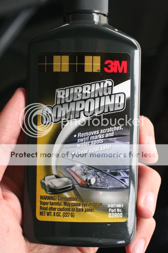

Wetsanding: take some 1500 or 2000 grit sandpaper (depending on how bumpy your final coat is) and a spray bottle with water (a tiny drop of soap if you want, but I never saw the need). Moisten your sandpaper and spray a mist of water over the clearcoat. Go over it all until it feels perfectly smooth to the touch, being sure to keep it all pretty damp. I don't think an excess of water hurts, so don't be afraid of it. If there's still significant bumps, go at it with a lower grit sandpaper. If you go below 1500, then finish off with a second wetsand using around 2000 grit. Be aware that you are taking a hint of the clearcoat off, so be sure to get a good enough coat on to begin with, and don't spend too long with a <1500 grit paper. Wash it clean. You will now have a perfectly smooth (to the touch) finish, but no shine. Now do a quick rub down with a polishing compound (turtle, the green can). Then go use the 3M rubbing compound (says rubbing compound, but is designed to take out 1500 grit sandpaper scratches. Get it at autozone, like $7). It is the key to popping the shine on it! Do a good rub with that, 2 if you really want it shiny. Then if you want, use some Meguiars ScratchX (carefully, don't put too much on, and don't let it sit too long, it can leave marks). Finish off with a good coat of a wax, ideally a paste wax, and ideally the NXT Generation Tech Wax from Meguiars, It's great stuff and goes a long way.
Here's the 3M rubbing compound:
