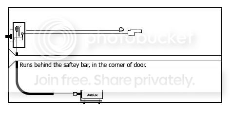

Update:
Just wanted to let you know. I have the 35Lb now installed in both sides and they work perfectly fine. Heck, I could probably use something even less powerful to open the doors.
Just so you know though, I have the popers mounted on the bottom of the doors, and a line that runs it through a spot in the back of the door through some cable insulators I pulled from a bicycle. This way the poper pulls side to side, along the bottom, but it pulls side of the door lever that was connected to the outside handle. This way it doesn't make my interior handles move when the popper pulls and requires less power to open the door.
Maybe this picture will help a little:
