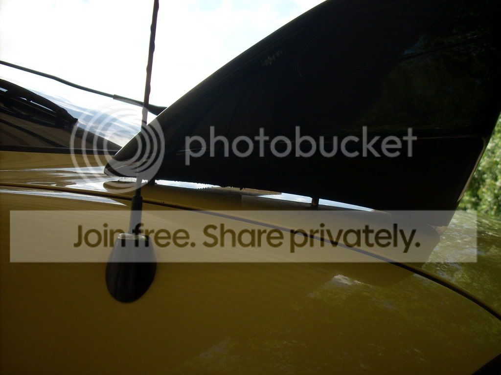

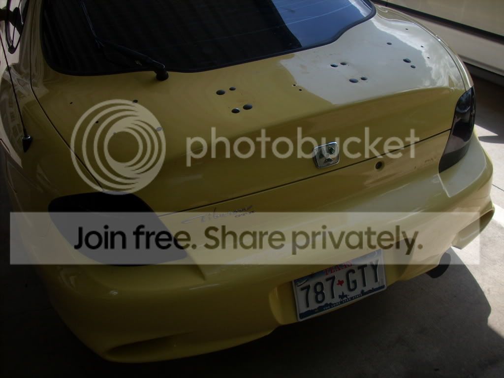

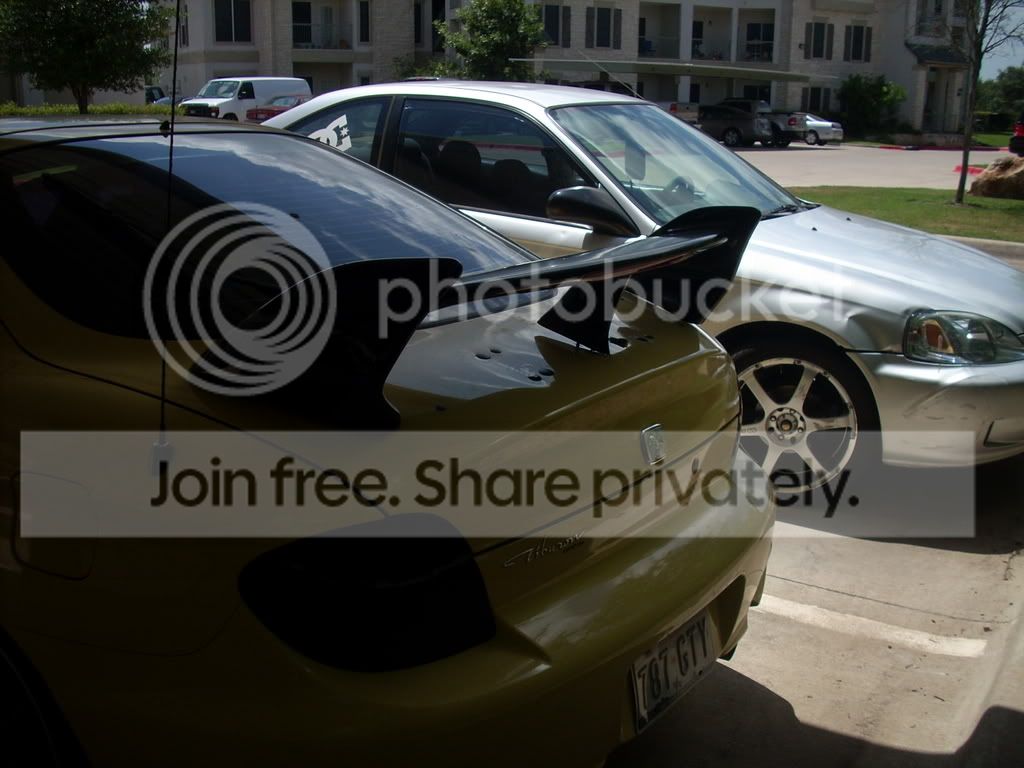

Here are a few shots at my new project....
Spoiler just sitting on hatch.
Yeah my tails are tinted now...and there's alot of holes in the hatch...
Holes will be filled as I work on my spoiler.
what do you recommend??

first off.. how many spoilers have you had on the tib.. lol theres more holes than in a piece of swiss cheese. lmao.gif
secondly, with previous experience getting a shark spoiler on a rd2. ( i had one on my car for about a week or so )
i would use bondo glass. or the easy way is to get some type of thick gasket foam and bolt it on as is. the foam will form to both surfaces, and if you keep it black wont be super noticable.
fyi, i think it would look good in black on the yellow tib with tinted tails.
for the bondoglass/bondo project, its not very hard, but a lil time consuming. just kinda eyeball the areas that need filler, then just throw some bondoglass on there, and let it dry pretty much all the way. bring it back to the car, set it on there and see where you need to sand/add more bondoglass. this should take about 2-3 applications from going back and forth. then sand it down as smooth as you can and fill the pits/rough spots with bondo. sand with 80, then 200, then 400, then 600 and it should be ready for primer.
but in my personal opinion, i would try some type of 3/8" or w/e foam, cut it to the shape and lay it on if you plan on keeping spoiler black. would look pretty normal.
I don't know about the foam thing. It looks like you mounted the holes in the wrong spots. Have you ever done body work before? Why don't you even have 2 spots touching the car?
