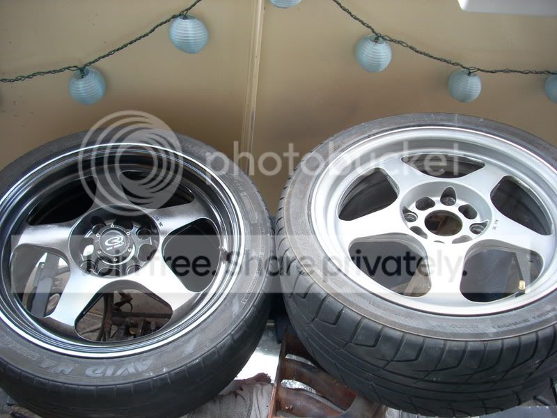

liz, it looks damn good. i can't get a good feel of the color though.. is it dramatically darker than the graphite color? the flash is throwing me off. it looks 100% better only polishing the part you did as opposed to the WHOLE lip.
how many cans did you use per rim of just color?
EDIT: can you PLEAAAAASE take a pic of one of the graphite rims next to the new color ones?

Yeah they only make the flat black. Using the clearcoat over it adds a bit of shine to it, but its hard to get the flat black even. So misting the graphite color over the black makes it more metallic, then I just added a sh!tload of clear coat after sanding it with 1000 grit sp.
So far between 2 rims I've gone through about 1 1/2 cans of black, 1/4 can of graphite, and 1/2 can of clear coat. I didn't use the graphite on the inside of the wheel, just kept it flat black.
It is a lot darker than the original color. Here's a pic, I had just sanded the lighter one down so its not as shiny, but you get the idea.
and once Im done with the lip it'll be much more shiny. Then Im gonna clearcoat that as well.

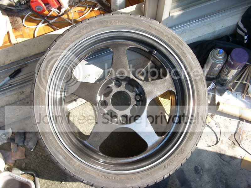

yeah thats why I put them off for so long, well mostly because I couldnt find tires in the size I need. I wanna stick with Yokohamas. But anyway just do them the way I did. They're pretty much metallic black. When you spray the flat black on, you gotta do it kinda heavy and even so that its nice and wet, otherwise it'll be really flat and dull. If you're gonna use non wheel paint make sure you primer them good so it doesn't flake off. I used filler primer to fill in the scratches. There's still some deep ones on the lip from curb rash, but whatever you only see them up really close. Beats paying $140 a piece for new rims, hah.

That should work. I actually ran out of the black wheel paint so I had to use some black high heat paint on the back of the spokes, blended in pretty well.
Anyway, just got the third one done, and I polished the lip on it fully. Im very happy with it.
