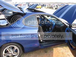

Here's some pix of mine. And that's how i did it.
ya, but after the 2 light coats, do a shiny one. wait for a bit and do a clear coat the same way. The clear coat will actually make it shiny.
If you want two tone like mine, Prep the whole thing. Tape areas to be painted. Paint. Dry. Tape off next areas. Paint. Dry. Clear coat the whole thing. You MUST be meticulous with the tape though.
Make sure you read the directions on the can though. I've done a bunch of spraycan painting. I'm pretty good. The guidelines i gave you should work on just about anything, but the manufacturer knows best.
