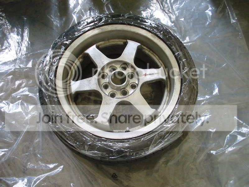

Well for those who knew what i went through with these wheels, i decided to paint the wheels before i sell them. It only cost me about 20 bucks and some elbow greese.
All four of them looked like this

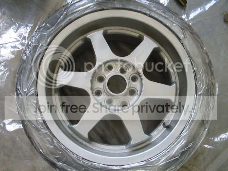

And after sanding
Primier...

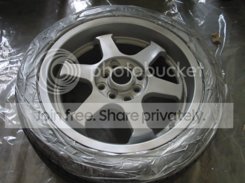

Color Coat...
Clear coat...

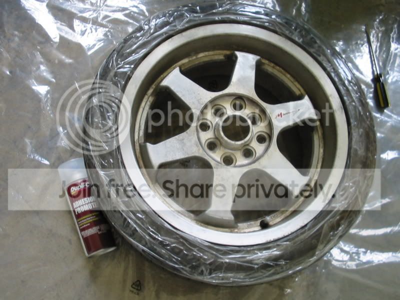

jay_m05- well the whole process is not yet completed. i still have one wheel to do. for me, it was one wheel a day but im 100% positive you can paint all 4 in one day. I did it one at a time because the first one i did was a test, so if anything went wrong i would kno what to do different on the other wheels.
Yeah i used everything duplicolor- adhesive promoter, wheel paint, and clear coat.
majiktib- the front is pretty much not going to go on. heres the story....
http://www.rdtiburon.com/index.php?showtopic=8544&hl=
Dmitry- the first wheel i did, i sanded the wheel a little bit. I later found that i needed to sand off all the clearcoat because when i priemiered the wheel, you can see the wheel crack/bubble. On the second wheel, i made sure there were no trace of clear coat left on the wheels before a priemiered.
