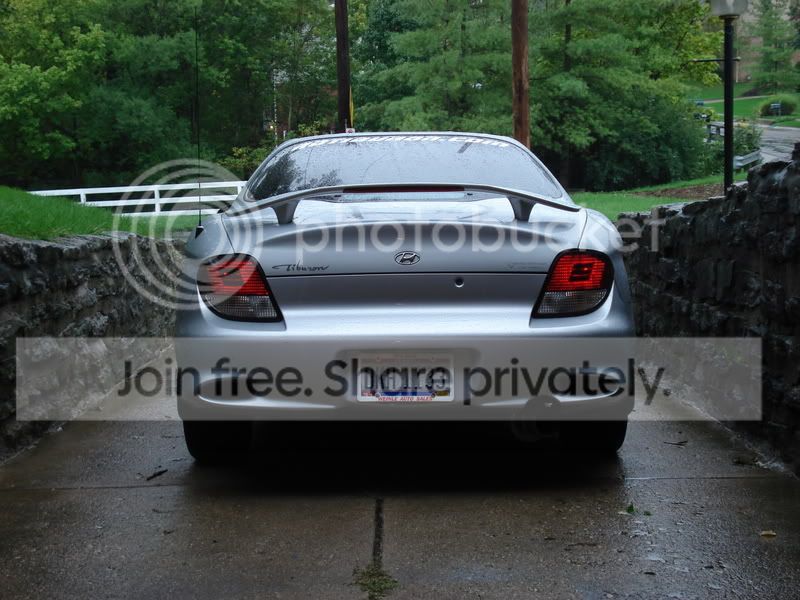

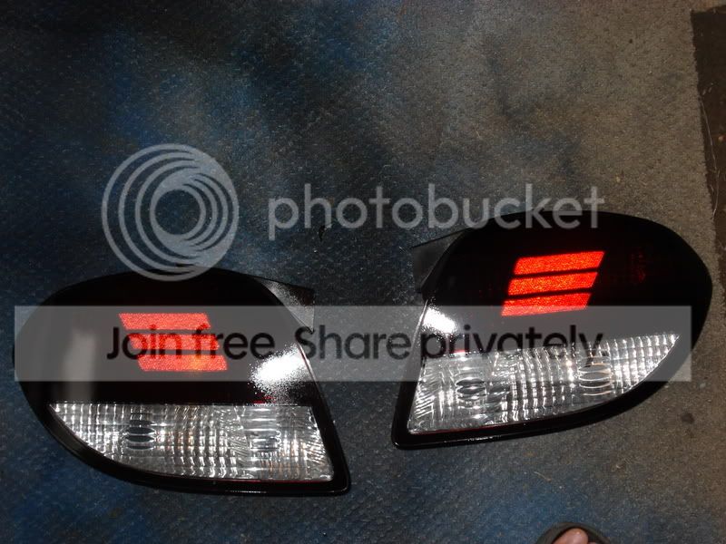

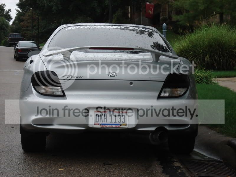

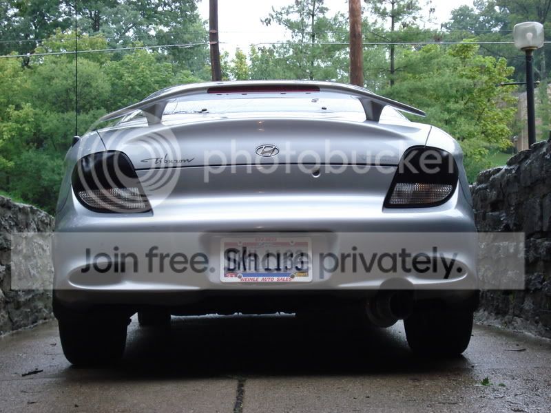

I just put on some black euro tails and decided to finally do what iv been thinkin about with my stock tail lights. Took some nite shades and some clear coat and came up with this....
Before Instal
Euro tails so you can see which ones you like better...

I like the blacked out stockers better.
Old Sep 25, 2006 | 09:39 AM
Tibracer33's Avatar
Posts: 366
Vehicle: 2001/hyundai/tiburon
I like the blacked out stock ones also.

like the tinted stockers,, now what u do to give it the glossyness?
what was everything you used on em.. im tryin to think what ima do with mah front lights..
Old Sep 25, 2006 | 02:24 PM
homey14h's Avatar
Joined: May 2005
Posts: 1,931
From: Ohio, USA
just a few layers of nite shades, then few layers of clear. if you wet sand, youll get better results from teh clear coat...use higher than 1000. i used 800 after i put the niteshades on and i think it was a little too rough still. I sanded them down with the 800, applied niteshades, sanded down ONE TIME very lightly with 800, then clear.
