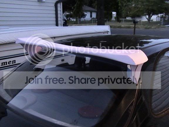

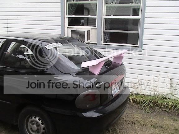

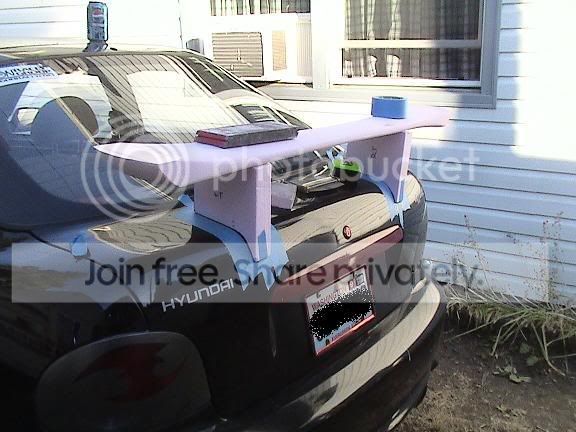

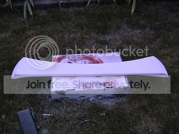

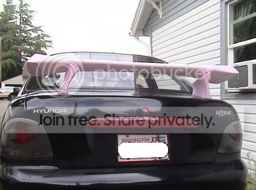

I actually started working on one last summer. I'll try to finish it this coming spring. I used pink foam insulation from Home Depot. Started with 2". I researched designs I liked and based a design close to but my own style. Heres a pic of what I had done so far.
Its not going to be that high. I was getting an idea to roll the footings over the lid edge.
You have to take a lot of measurements. I also recommend getting a contour gauge, you can find them at hardware stores. Normally used to copy the angles of trim molding in carpentry. cost is $8.00 +/-.
I originally was going to make a rear air wing off the top of the window,
but decided to make a rear window lip visor. No pics of that yet.
But also recently, I had found a spoiler on a 03 Nissan Maxima at a wrecking yard that I was able to buy for $12.50 with 3rd brake light. I'll probably be modifying it to suit my purpose, but I'll also finish the other one too.

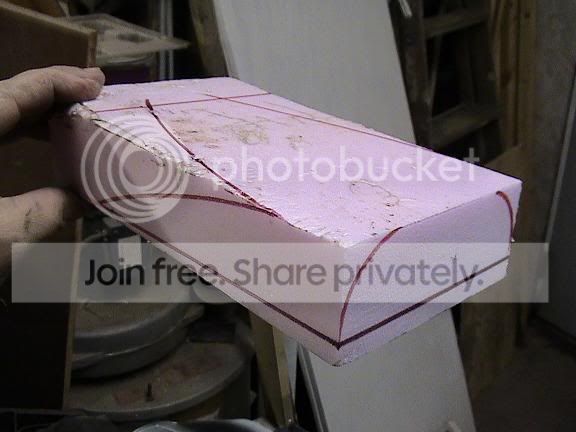

When using this foam, and going to glass. Use Epoxy resin, not the polyester. The poly will eat the foam thus needing to use spray glue and tin foiling your work. the epoxy resin will not eat the foam. A little more spendy but also a hardy material when cured. so if you're worried about cracking, epoxy will be strong enough.
Hope this helps. I used a course grit and a fine grit sanding blocks. And a long utility knife. I drew my lines similar to those on my scoop i'm making aswell to show you what I'm talking about. Draw your lines to get the profile you are looking for then whittle down to those dimensions.
To get the shape you are looking to make do this....
So just apply this to making the spoiler.

^^ I'm really good with electronics. I have not the slightest idea about how to start a project like that. Could you break down the use of the contour gauge, as well as how you got the lines onto that piece of foam?
