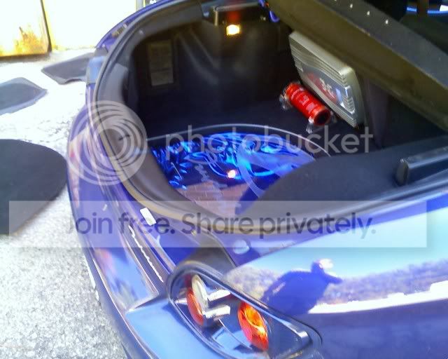

I need a clear set of tail light covers for my car. I believe they would be the same as the smoked set on K-Spec, but I would like them clear. Here's a pic of my rear. What are my options?

If you still have your original tails.. you can bend plexi to fit. Put a piece of felt over the original lense (make sure it lays flat) and then the plexi. Slowly use a heatgun to warm it until it starts to get soft and mold itself to the shape of the lense.
It will take time because you do not want to go to fast and melt the plexi.. but it can be done. All you need to do then is cut it to fit and then glue it into place.

It looks nice without the lenses......If I pull mine off to paint them like you painted yours....I'll let you know.
