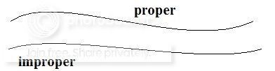

It does not matter how it sounds. It's quite impossible for this antenna to actually grab a signal like a 60inch, 30inch 15 inch or 7.5 inch antenna. It is not tuned for the magnetic resonance of a radio wave between 88MHZ and 108MHZ.
I am an electronics tech. I specialized in RADAR for 6 years. Each frequency has it's own wavelength. I will now explain to you why I said this and try to keep it simple because this is actually a whole field of study.
Each frequency has it's own resonance, this resonance is at 1, .5, .25, and so on and so forth. When you design a pickup device you need to know the frequency for which you are designing the antenna. The reason is each frequency has a wavelength. That wavelength is measured in distance. As a wave moves it actually covers a speciffic distance between pulses. If you do not tune your antenna right that wave will come in distorted. This is the reason all car antennas are between 30-36". this is also the reason you can get a better TV reception with rabbit ears partially extended but when you fully extend them, it gets worse.
In order to calculate the lenght required to tune an antenna to a speciffic frequency, you've got to know a few things. The speed of radio waves, which is the speed of light, or 300Mm/second (megameters). 100MHZ is about the middle of the dial.
If you divide 300,000,000 meters per second by a frequency which oscillates 100,000,000 times per second, you're left with 3 meters or about 120 inches.
Now for resonance, 1/2 of that size will give you 1/2 of the wavelength, this is where the sweet spot lies, but 60" is too long. The 3rd resonance is 1/4 of the wave length, which is our antenna, about 30". the 4th resonant is 1/8 of the wavelength 15" and you start dropping more signal.
You can read more about designing an antenna by searching google. Just know that this antenna is not tuned for radio reception. It belongs on a 900mhz cordless phone.
