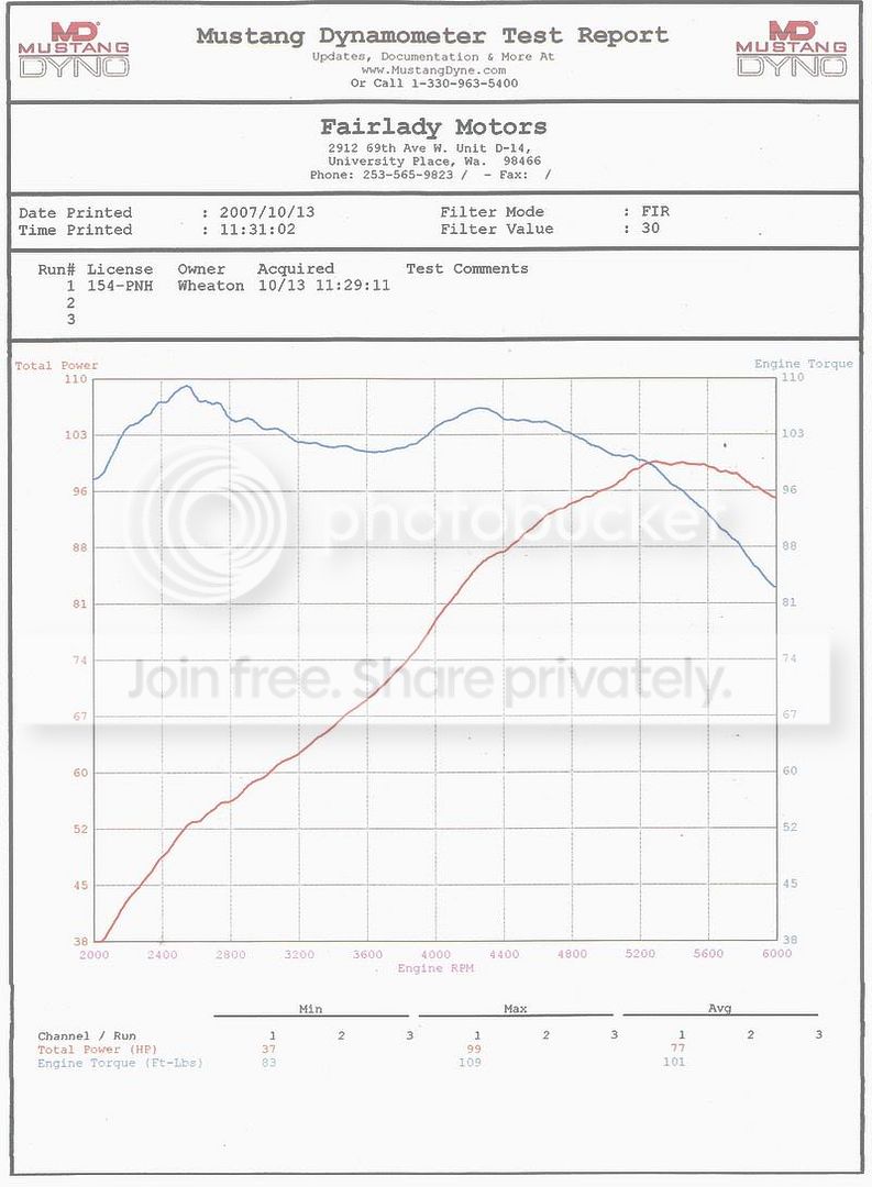

I have the Evofusion 4-2-1 header.
I am happy with it. Mine was an early model and came with the wrong down pipe. Aside from that it's great, has held up great for about 5 years now, and IMO performs great.
With I/H/E 100whp, 109lb/ft of torque at the wheels.
If anything there is less torque below 1500rpm's than stock, but it ramps up nicely from there.
It is a fairly constant torque from 2500-5000rpm's. The double peak is either not really there, or not as noticeable as that looks.
