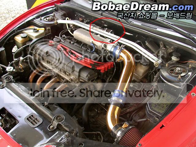

So what did this guy do? It looks like he put a small breather filter on the bigger one...
That's what I was hoping to do too. Less mucking around with the piping.

it's a korean tib, so it's probably different with some things. I know for sure that they have no MAFs, they use MAPs. My XD is MAP based and I don't have any piping coming off from nowhere.

I also have a MAP based car, so will the setup above work?
