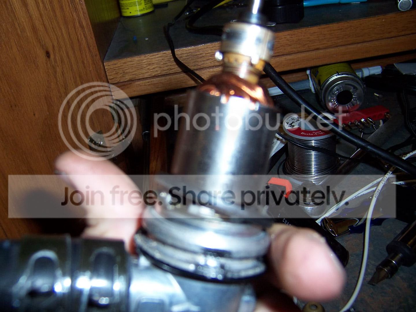

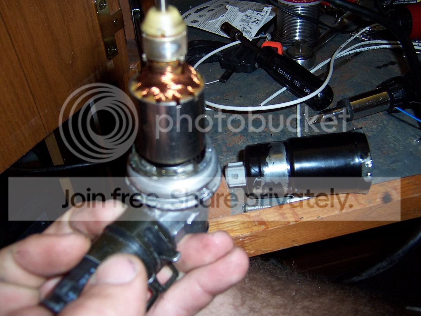

I took apart the IAC which was on my car and found some buildup on the contacts/brushes. It was black in color. Upon reassembly I found that the resistance dropped to within tollerance.
Hyundai specifies a close tollerance resistance value on the IAC for a reason!
Here's some pix.
In this picture, at the top, you can see the black buildup I was talking about
In this picture, you can see an adjustment of some sort for the IAC spring. It's the brass thing at the bottom of the IAC mounted to the aluminum. It can slide back and forth with some pressure. It actually sets the stopping position for the IAC valve. Any ideas on the proper setting?
I believe this problem was caused by buildup on the IAC contacts. Some buildup could be to blame if it were causing intermittant contact at just the right place
I need some kind of a press or a big pair of plyers and a tool to press in the edges so that it stays together. I'd say a repair on this part is feasable as long as you have a strong tool to bend the pressed fittings back into their proper location and you reassemble it correctly.
