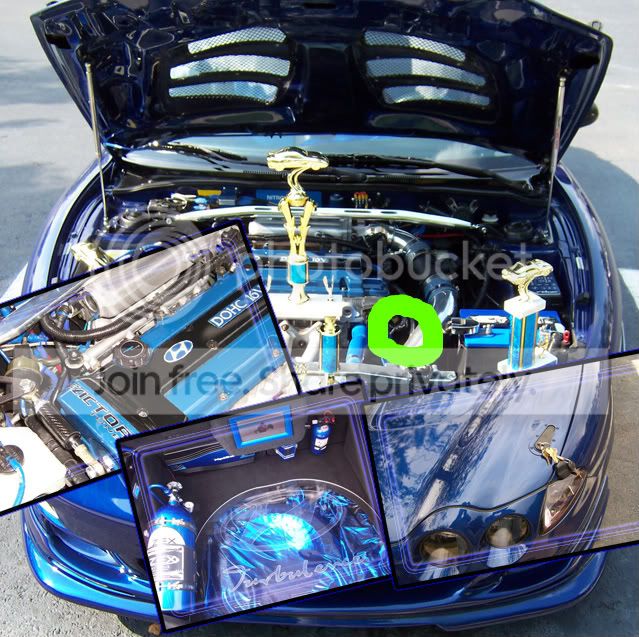

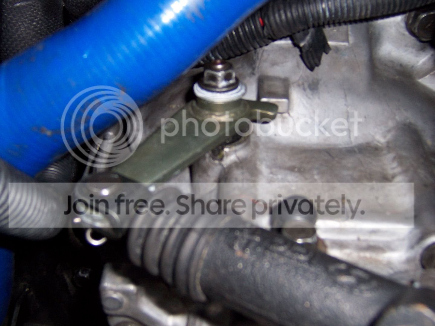

can DTN or somebody else give him more direction on the lever? It's located on top of the transmission, should be able to move it with your fingers, push it back towards the firewall I think?
It's located right here (green)
It looks like this
rotate it towards the firewall

Clutch issues are odd smells, slipping, bearing noises, thumping or thudding and clutch pedal issues. Unless your clutch exploded and sent fragments through the bell housing, you don't need a new transmission, you just need to adjust your clutch.
