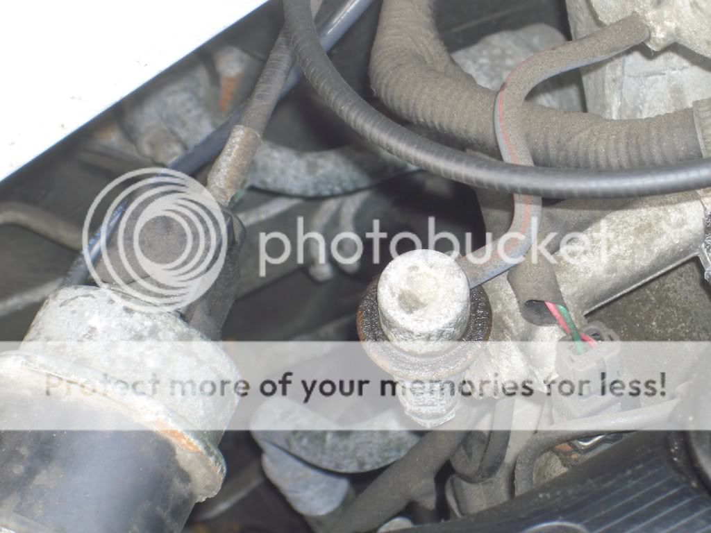

I'm wondering if my fuel pressure regulator is going out. There is a wet ring all around the top of it, where the top is crimped onto the main body. This ring doesn't seem to be growing any bigger over time. It just worries me to see a wet ring where it doesn't seem to belong. The engine idles well and is running just fine.
Regulator
Yes, I know I have to clean the engine bay.

apparently this is a common problem, mine's doing the same thing. I wouldn't worry about it.

Well, I replaced it, and there is a difference. Smoother idle, and more consistency across the powerband. When you have an extra $50 and want to keep up the car, replace it.
