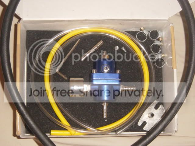

Just a question.... I just bought an OBX Fuel Pressure Regulator that is a boost dependant and a Walbro 255L fuel pump. Can I install both without getting Turbo??

Can anyone help me to know where can I install this on the engine bay?? and how can I install this?? I know where is the vacuum hose is connected, but the others?? I just make a search but can find any picture... or OBX installation...
I have to take out the stock FPR and replace it with this one...
thanks for the help pals...

You will need to get an adapter plate that goes on the fuel rail that has a fitting on it. You then connect that to the 90 degree connection on the FPR. The connection on the bottom is for the return line. The stock return line must be replaced up to where it clamps to a steel fitted line coming off of the firewall. Hope that helps.

Thanks... I see it more clearly.... but a little confuse.....
Do you have any picture???
The FPR has to be installed in the exact position as the OEM FPR??

Not mounted in the same place, just connected at the same place. I have mine mounted to the firewall.
You can see mine in the bottom of the pic. I will try to get more pics this weekend.
