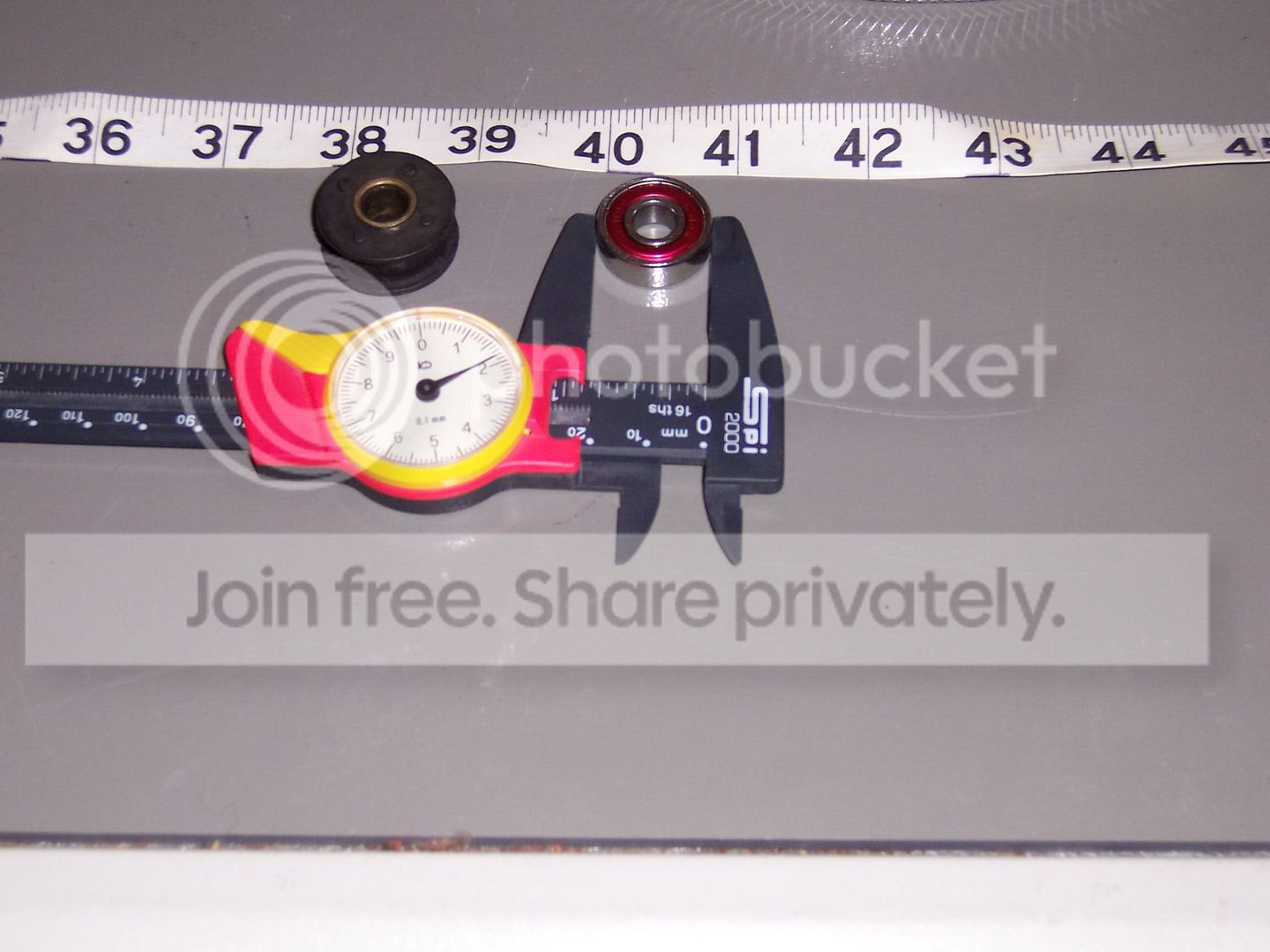

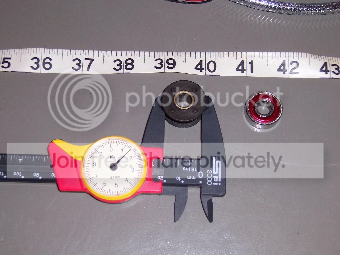

The inside diameter of the bearings is the right size for the stud on the shifters on top of the transaxle. The lower/rear location on mine took a little persuasion with a hammer to get lined up, but when they got onto their studs straight, they slid right on.

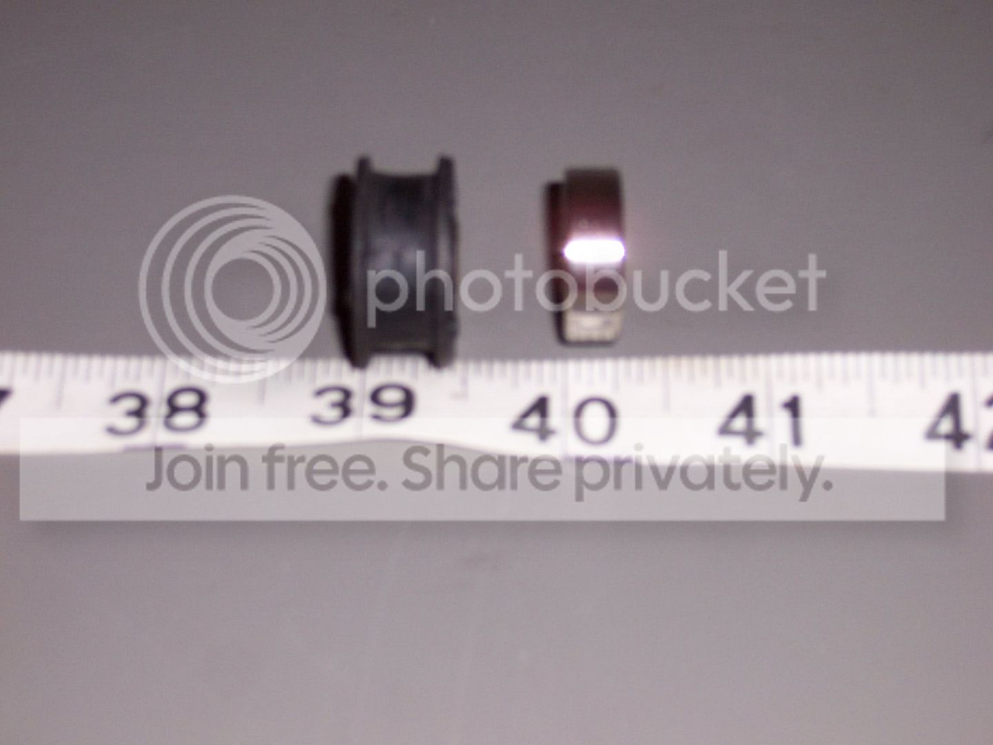

The outside diameter of the bearings is about a millimeter too fat to fit in the ends of the shift cables. Take a dremel with a sanding drum to the inside of the shifter cable ends, or the outsides of the bearings, until they fit. Do NOT try to get cute and make it a press-fit, unless you have the right equipment... my dad's "press" was a socket and a hammer, and he dinged up the bearings a little. Just adjust the clearance so they will go in by hand, maybe a little snug.
The stock bushing is a rubber part with a metal insert. With time the rubber dries out and the shifter feels sloppy. Push/cut the old bushing out and get the skate board wheel bearings to fit and mount them in the ends of the shift cables. I used a little grease but I am not sure it will matter if your bearings are in good condition (mine were used and a little gritty). Get some washers to put on the sides of the bearings to take up the extra space on the studs. I used washers that were for 1/4" bolts and they fit pretty well. I'll try and remember to shoot it and post a picture this week. Mount the bearings before installing the clips that hold the shift cables to give you a little slack.
With the bearings in there, you can definitely feel a much more direct connection with the transmission. In theory, with new bearings that weren't hammered into place and damaged wink1.gif , they will rotate smoothly and you won't notice them. Mine, you can feel them crunch a little but it's still better than sloppy old rubber bushings.

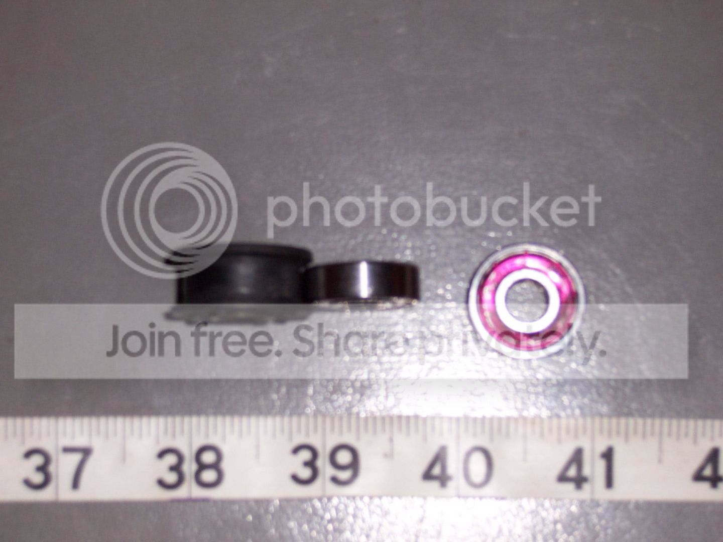

Hey, thanks for the info on the shifter bearing swap. I went to the skate shop and selected some grease bearings. Grease bearings are different then roller bearings as they do not move freely without tension on them. This means they stay put unless you're trying to shift. This reduces play greatly.
I used a giant C-Clamp to press the bearing into place after I removed what seemed like quite a bit of material from the inside of the shifter cable end hole. While removing material I checked quite a few times to see if it was getting close enough to press the bearing into the hole.
The inside diameter of the skate bearing was perfect to match the OD of the pin on the shifter, in fact, it was almost too perfect.
One bearing per shifter was enough. Extra washers were used to remove extra slack up and down on the shifter mechanism, but because of the tight fitment on the ID of the bearing, the extra up/down slack is irrelevant because it cannot move.

It feels perfect. I can feel the moment at which the gears make contact. When I downshift at too fast of a speed I can feel the transmission rejecting the advance into the lower gear unlike before. I can feel everything. It makes me feel like I'm more in contact with the transmission.
