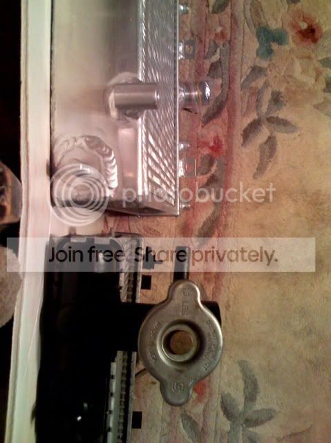

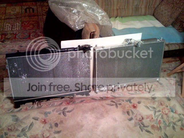

So I wanted to try an experiment seeing that the Evo8 engine bay is nearly identical besides being a bit more beefy, and beefy exactly what I got today. It's huge, but it will still fit if I get the mounts rewelded. All aluminum Evo8 2-row radiator for 1/3 the cost of a Koyo.
L X W dimensions are exactly the same, but the EVO is about an inch thicker. I will have to get rid of my A/C fan. No biggie. Extending the overflow hose, no biggie. Inlet and outlet size are approximately the same as ours. Overflow hose also the same.

I don't see why it wouldn't work. The heat from the exhaust shouldn't be an issue, an inch closer isn't enough to crack anything, and since it's bigger there should be more cooling power from it, preventing any issues. Plus it's sorta designed to withstand heat... It's a radiator...
And since javageek has the half core radiator with no apparent problems, I don't see why a bigger one would hurt. You may want to get a different thermostat to take advantage of the extra cooling power.
As for your engine going boom? No way. Like you said, it's a pretty simple component, and it should work great!

The reason I switched to the half size was my manifold was sitting about 1/2 inch or so from the stock radiator. This was causing the radiator to be extremely less efficient. How close are your headers going to be when it is mounted? You may not notice it as much since it is a better than stock radiator.
sounds good guys. i'll look into finding a thermostat, if you can steer me in the right direction, ebay doesn't have any. maybe summit has some aftermarket ones. i've never looked into that. the reason i'm experimenting this is because i want it to last. hyundai makes some cheesy radiators.
^javageek it's about the same, 1/2 inch away, bottom line it isn't very good. but they are gt headers so most of the heat is upstairs and gets out through the cowls.
