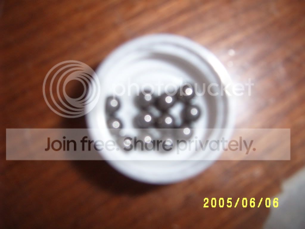

3) My last biggest concern is after a couple of starts ball bearings appeared on the ground in front of the car. There are 12 that I found. I talked to my mechanic friend that said the automatic tranny uses some check bearings to regulate its fluid. He also said they typically only come out when you drop the pan on the tranny, which I did not do. Plus they were no where on sight till after the start of the car. I’ve browsed the manual and cannot locate any ball bearings usage. Also, hard to tell from the picture but they are completely smooth around, so they appear they did not break from something otherwise there would be a flat edge (possibly).

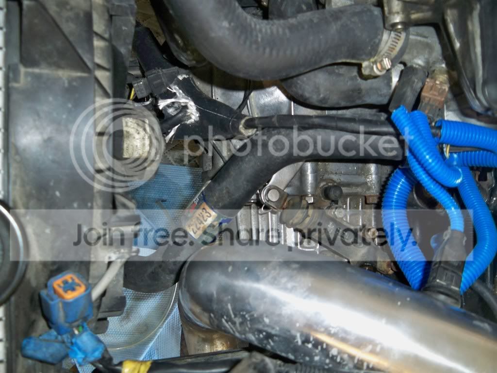

4) I also have a little concern on the electrical side: I can't get the key out of the ignition after the car is started, only when I unplug the battery. Here a picture where I think the key shift lock plug is, cause its the only one I could find the matches.

I think I covered the wiring in my conversion post (in my signature)
The bearings . . . I dunno. I had needle bearings in my automatic's pan. If a race just plain broke, the balls would potentially fall out and still look in good condition.
