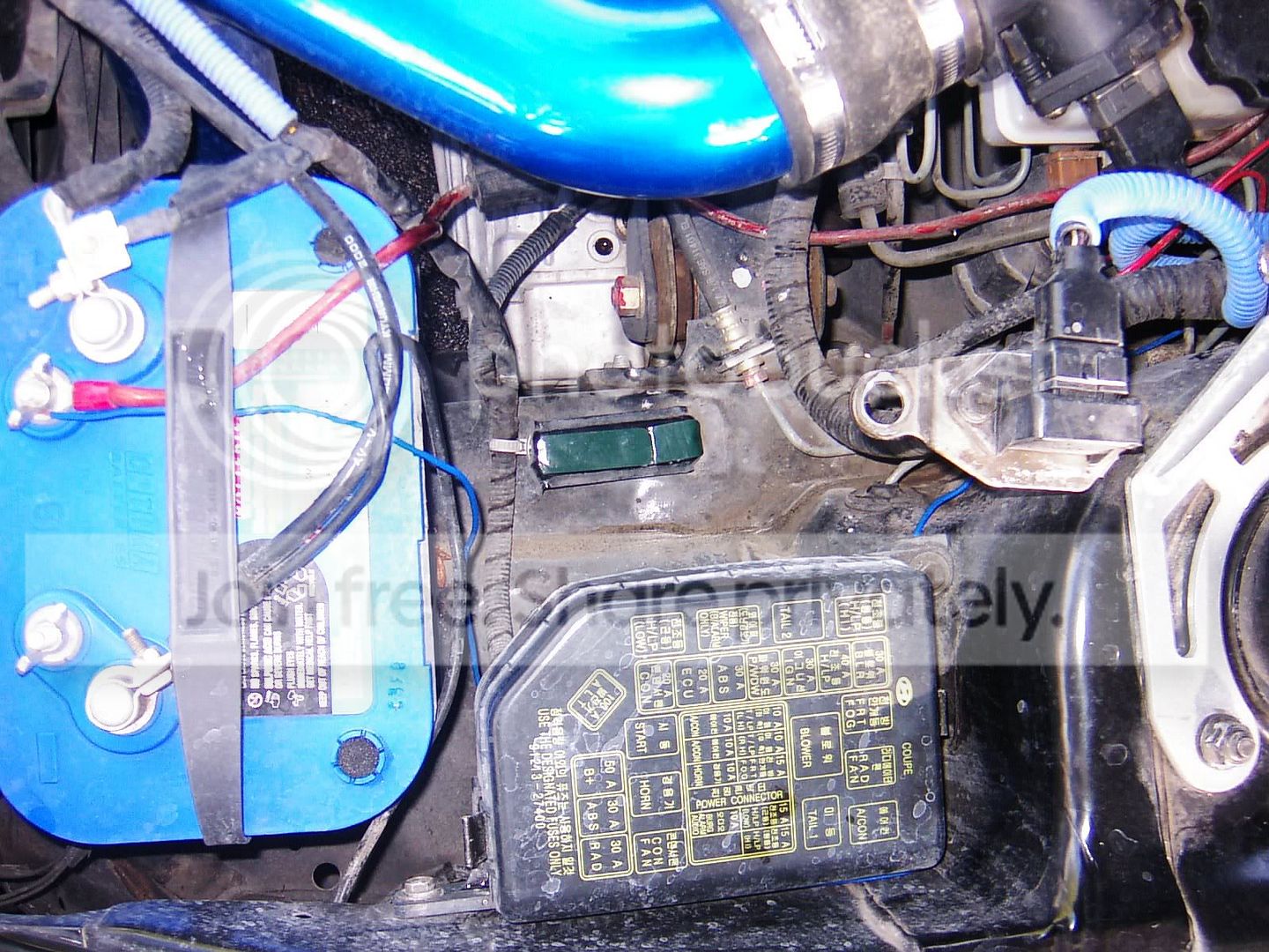

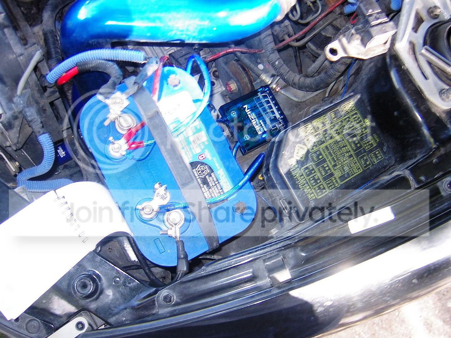

To run the wire, just cut the fuse off the wire that they put on the kit, then remove the 2 bolts holding your accelerator cable firewall passthrough. When you've done that, run your wire through there, and get an IN LINE FUSE holder, and put a 30 amp fuse in it. After that, it's all easy, just run the wire to the positive section of your battery, and bolt the throttle cable firewall bolts back on.
Done.
The blue wire from the positive terminal is my power wire to my relay kit.
In this pic, you can see the top of the in line fuse holder I used.
It's a neat holder, and just screws in place on the wire and uses the old tube style fuses.
Done.
