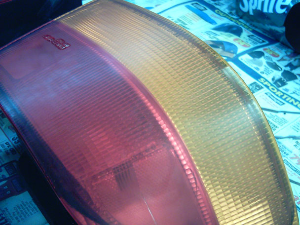

-wet sand tail lights thouroughly! any spots you miss will come out bad looking, sanding in small circles untill fine white foam appears should be sufficient. NOTE: tape off any areas that you dont want dark (IE reflectors)
-dry tail lights thouroughly, they should have a haze to them like this:
