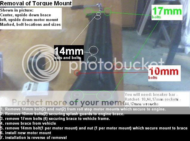

1. The 14mm bolt and nut which go through the motor mount is the toughest to get to. Just get a good grip on it and turn the bolts with a breaker bar. The side motor mounts should be bearing the weight of the engine. The torque mounts should not be under any pressure.
2. Remove the 2 little bolts securing the splash guard to the brace
3. Remove the large 17mm bolts from the 4 corners of the engine brace.
4. Move the brace out of the vehicle so that you can work on it.
5. Remove the nuts and bolts from the bottom of the brace which secure the motor mount to the brace
6. If you are pressing in a new mount into the old housing, then do so, otherwise replace your new one with your old one.
7. Installation is the reverse of removal.

Here is the bolt locations and directions for removal.

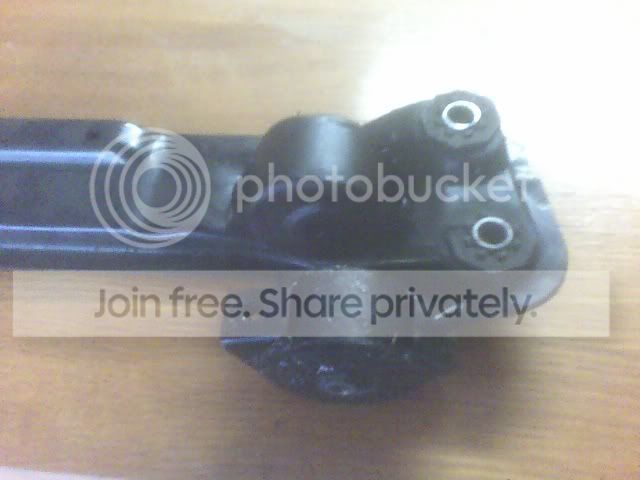

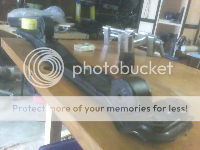

Here are some more pix of the brace with a solid rear motor torque mount and a second rear mount

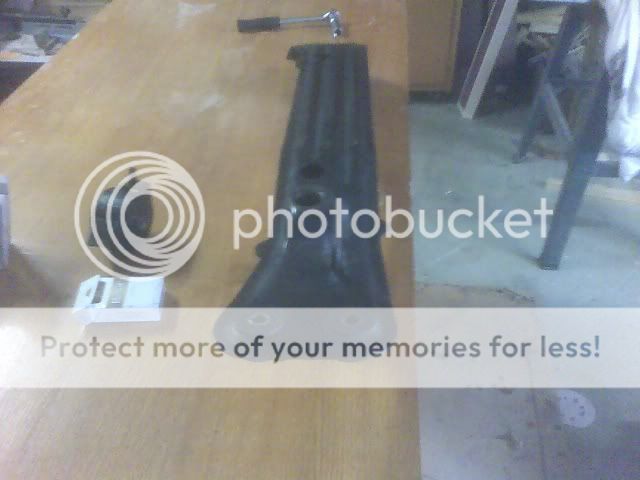

Here is a picture of the brace installed on the car. It is in the center of the car at the front under the engine.
