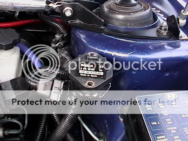

Removal:
1. disconnect electrical connection from Rough Road Sensor
a. remove the clip
b. disconnect the plug from the jack.
2. remove 2 10mm bolts securing the rough road sensor to the bracket.
Installation:
Installation is the reverse of removal
Notes:
There are at least 2 types of Acelleration sensors used in beta engines. These are 2 types.
