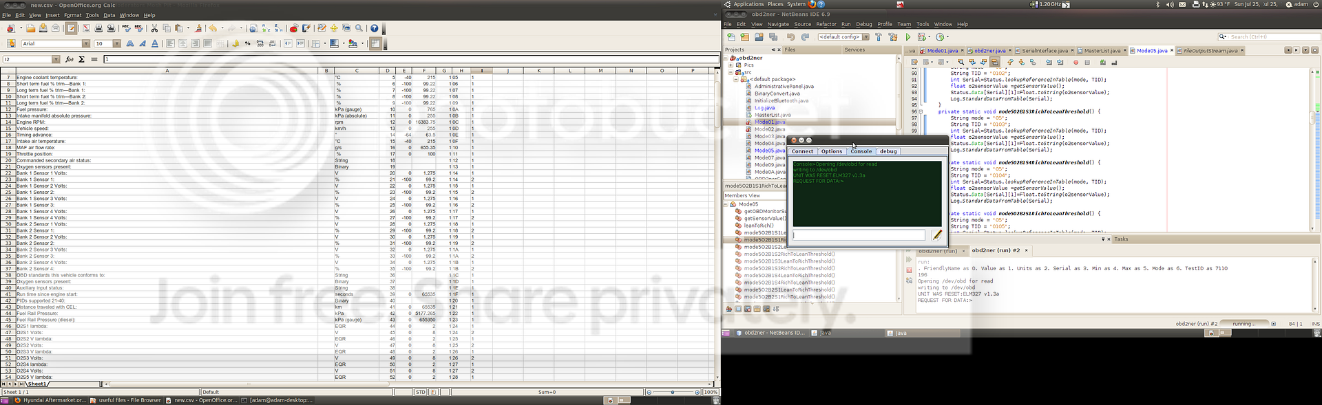

I thought I would share my current progress. The adminsitrative panel is working. I still have to add a "search" for codes option where you can specify some parameters to search for and let it run. I'm working on converting all of my variables over to tables. The Table will allow the user to click on a value and have a gauge displayed. The gauge will be customizable, re-positionable and allow multiple instances. It's still nowhere near done, but I thought this might be interesting for some.
Old Jul 26, 2010 | 12:43 AM
This is pretty cool and seems to be coming along nicely. Good work DTN. smile.gif
