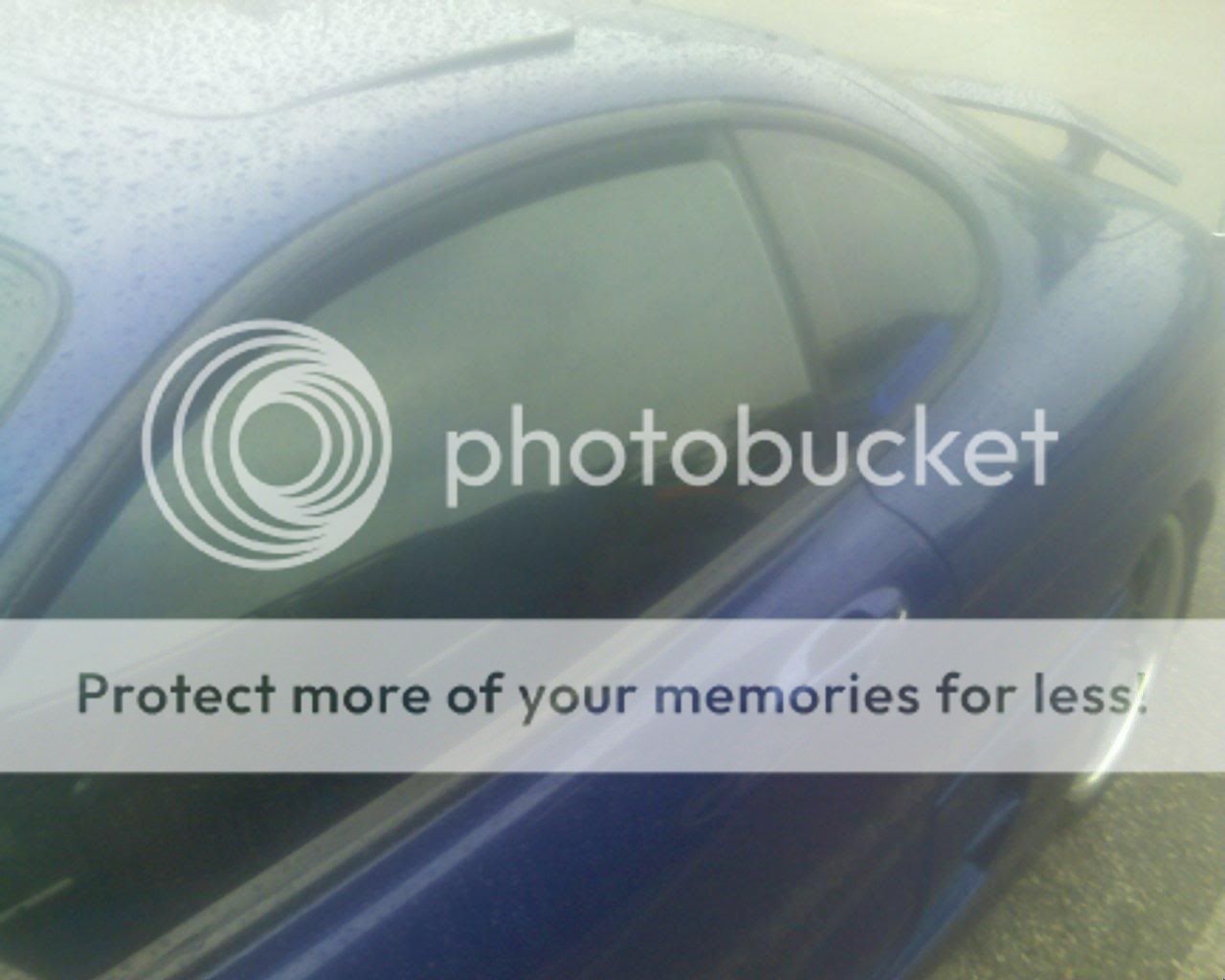

So anyways... I rolled up my window in the wash bay and then I hear a click, followed by a kerchunk coming from the window. I looked at the window and said "kerchunk?". So I pushed the window down button and the window went crashing to the bottom of the door.

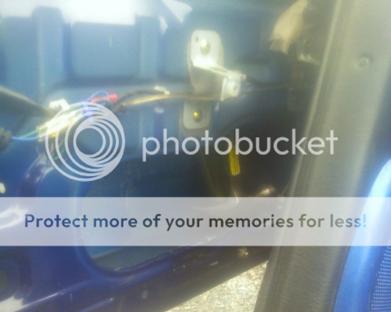

So there goes my plans to wash my car. I took my door apart and found that the window regulator cable had snapped. I remembered that I had just shut my door at walmart with the window 1/2 down, which is something I never do. Also, prior to that, the window had been making a click noise when it goes all the way up and all the way down. This should be a warning sign for anyone reading this thread.

DTN, as your pulling the window out of the car there should be two plastic pieces that are bolted to the door. One at the front end of the door near the mirror and one to the back. Unbolt these and turn them upside down and put your window back in, they will hold it at just the right height to get a good seal against the rubber. Then remove the hammer.
This method also allows you to easily remove the window and place in the trunk for those sunny moments you want the windows down!
