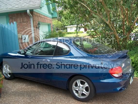

Ok heres what it looks like now

Oh yeah, they're gettin' lower. I'll be you lose another 1/4 + until they finally settle. Ride height does look good now though.

Yea they got a little lower, about half a finger width, the one rear right was up hight than the others then i shook it and it lowered lol.gif good thing I read this before I noticed it because I would have freaked that one of my springs or struts I thought was messed up
