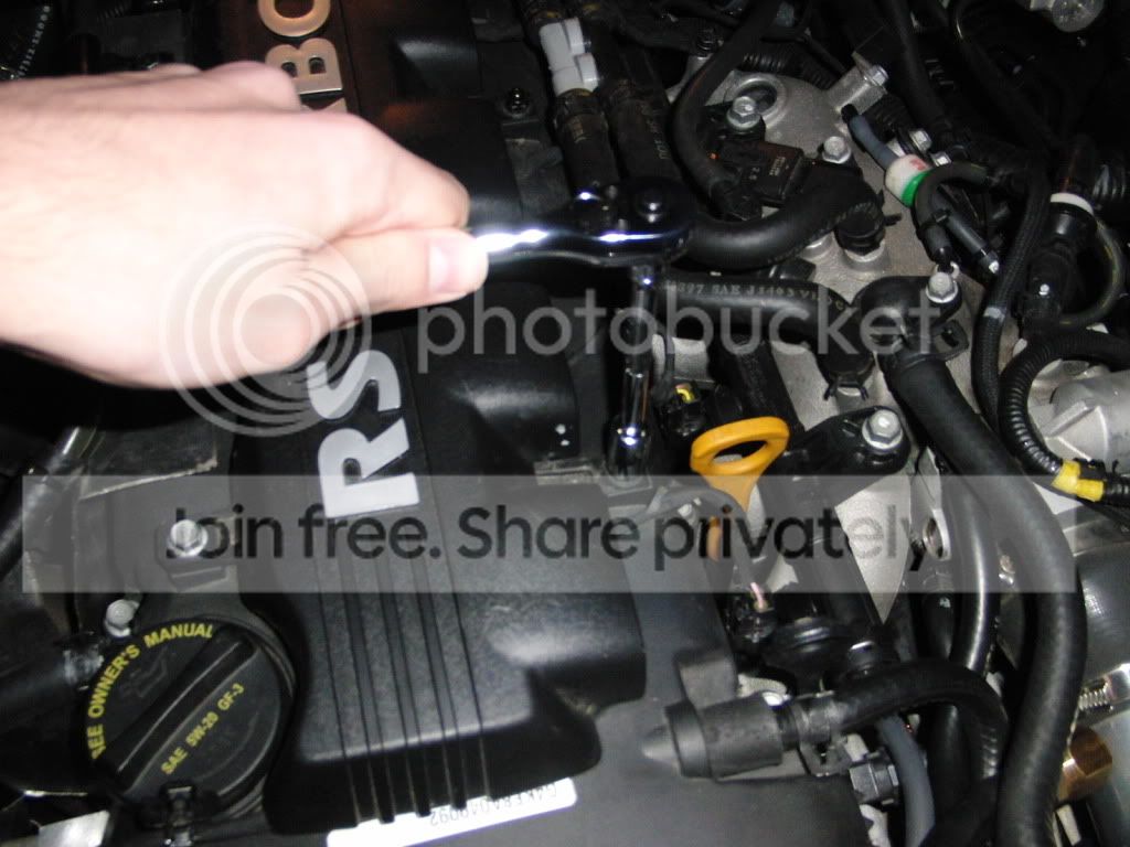

2. Take off the 4 bolts (10mm) holding down your spark plug/engine cover. (Tightening specs not listed, but make it snug when re-installing.

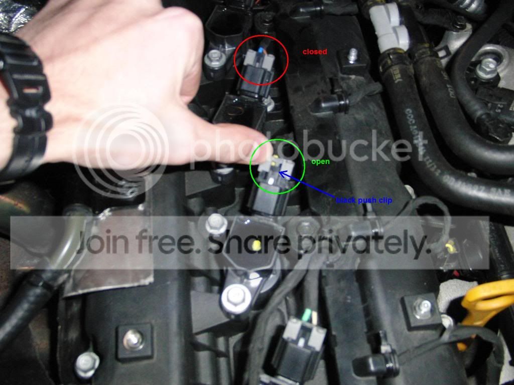

3. Push the gray ‘lock’ on the electric connector up. Then the black center of that (was covered by the gray) needs to be pushed down. Then pull the connector off, you don’t have to pull hard, just firmly on the connector, not the wire.

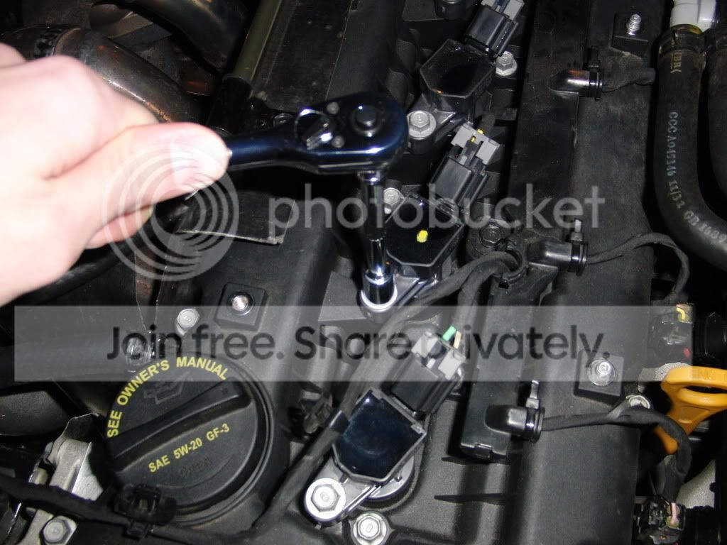

4. Unbolt the 10mm bolt holding down the spark plug coil plug. (Again no specs, make it snug).

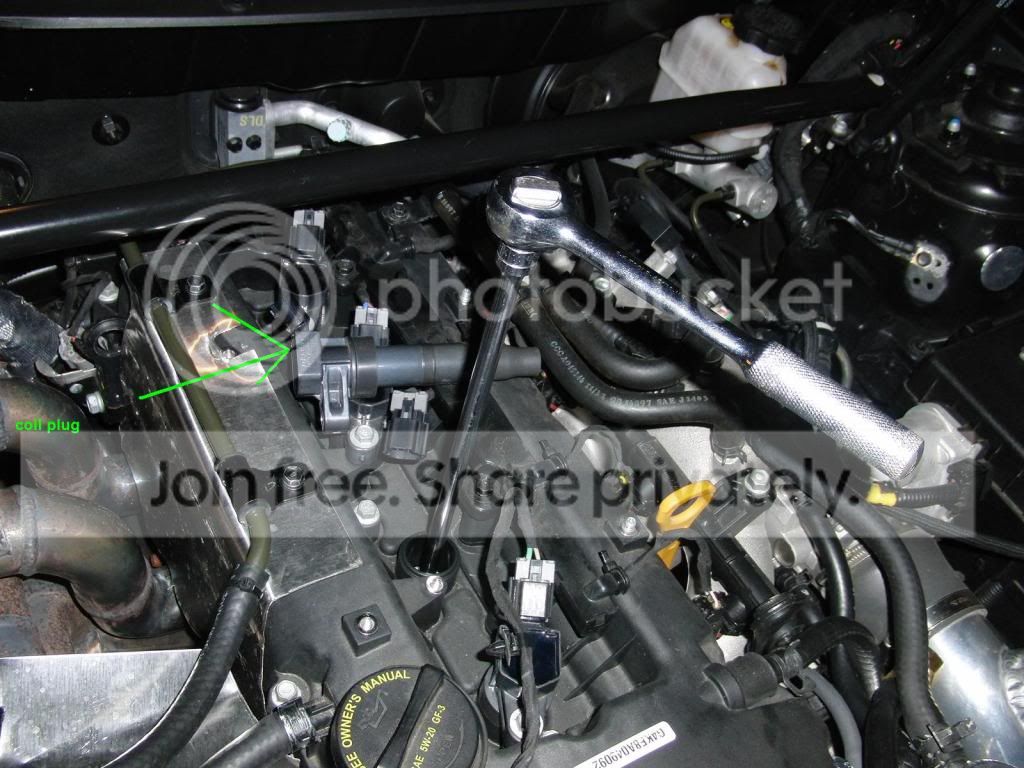

5. Pull the coil plug off and set it aside. I like to do 1 at a time so I don’t confuse which one goes where.
6. Stick your 5/8” socket on at least 6” extender into the hole and over the spark plug. Take the spark plug out like and screw, turning counter clockwise. (It takes about 16-19 turns) Once you feel it loose, pull your ratchet out with the spark plug still in it. Sometimes your socket might come off the ratchet, in which case stick it back on and the spark plug probably wasn’t out the whole way. Put a clean rag or something over the hole so dirt/contaminants don’t get into your engine and take car that nothing drops in there.

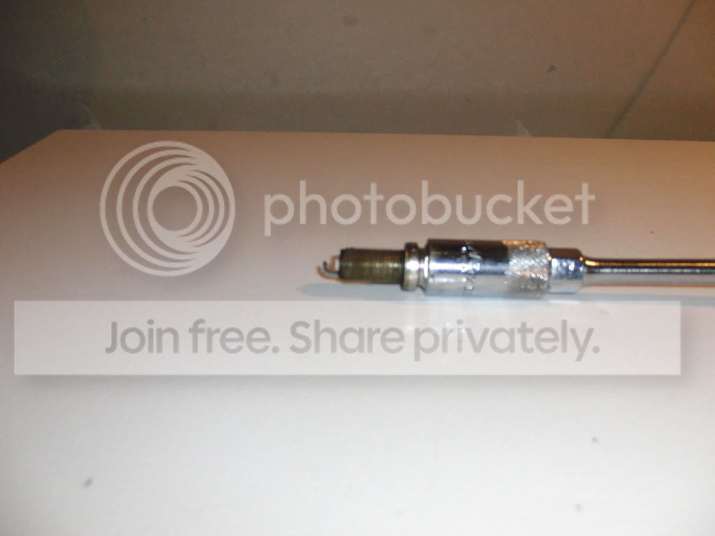

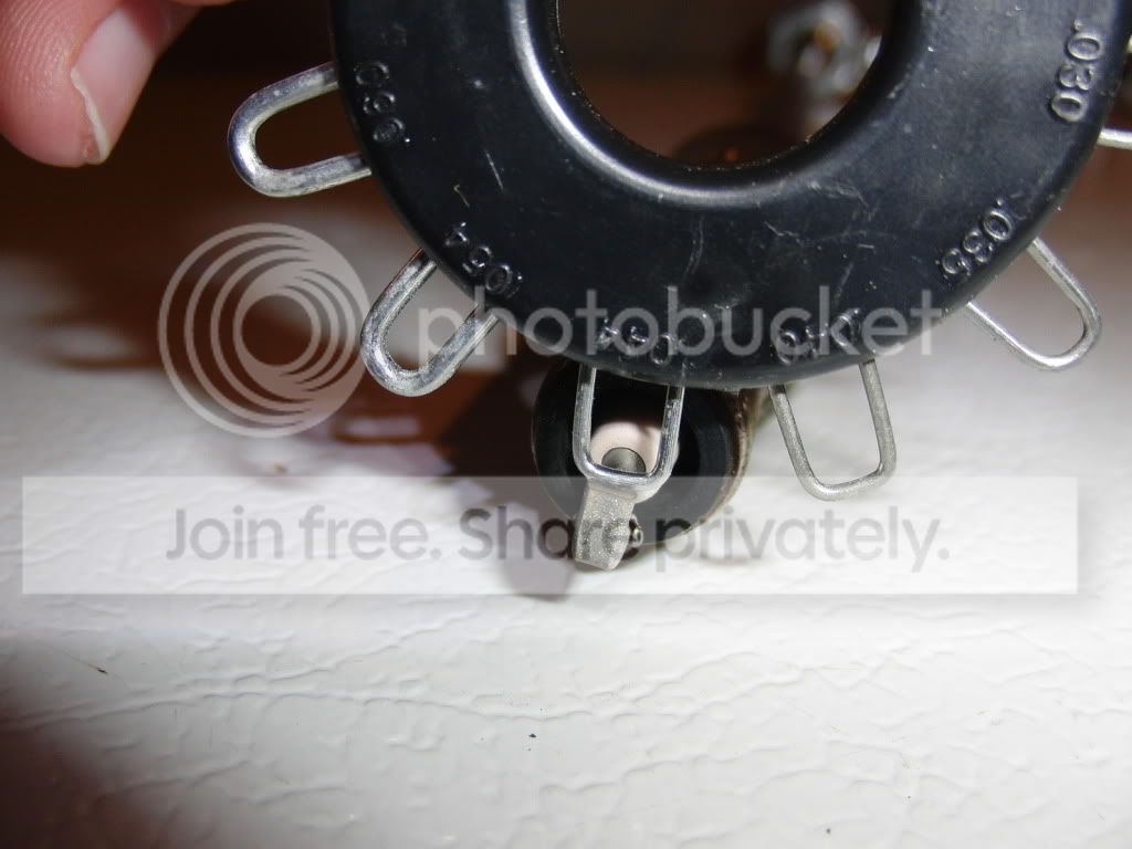

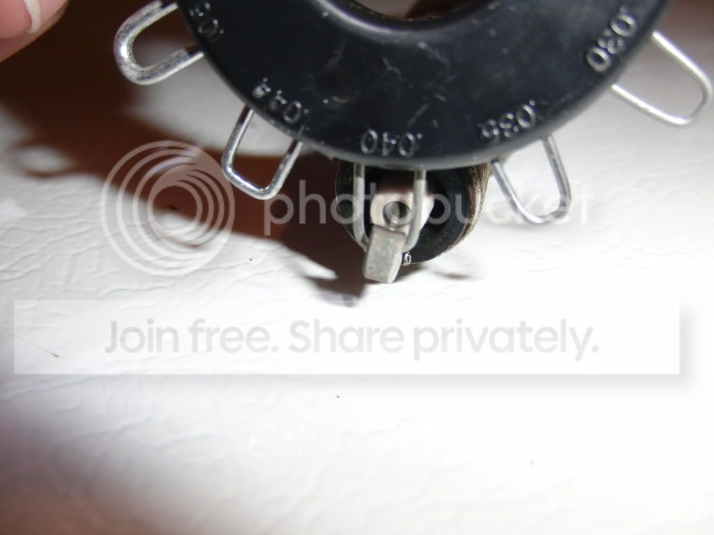

You can see me checking my gap here with a common spark plug tool. You can see the .040” fits in no problem, but the .044 won’t fit. So my gap is probably a .042”. Do not use a feeler gauge to check gap or a progressive sloped gapping tool. Also if it is very close to .04" using a gapping tool, don't force it through, you could rub some of the irrudium tip off.
Those have about 16,000 miles on them and you see the porcelain and electrode are clean. This means my plugs do have a proper heat range to burn off all the carbon, possibly too hot, since I have had light detonation before on my stock car, but that probably has more to do with the fuel tune than the heat range. I don’t have any pictures of ‘bad plugs’ but you can Google “spark plug diagnosis” and find plenty of pictures and examples.

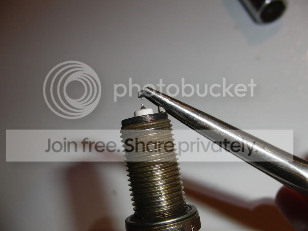

8. If you want to adjust your gap, you MUST TAKE CARE NOT TO TOUCH THE TIP or THE GROUND or THE ELECTRODE or THE PORCELAIN. This is an example of how to ‘properly’ adjust the gap by pinching the ground strap and bending it up or down to increase or decrease the gap. I use the term properly loosely as they do make spark plug gapping tools for ~$50. But it isn’t that hard and many people use needle nose pliers to change their gap.
