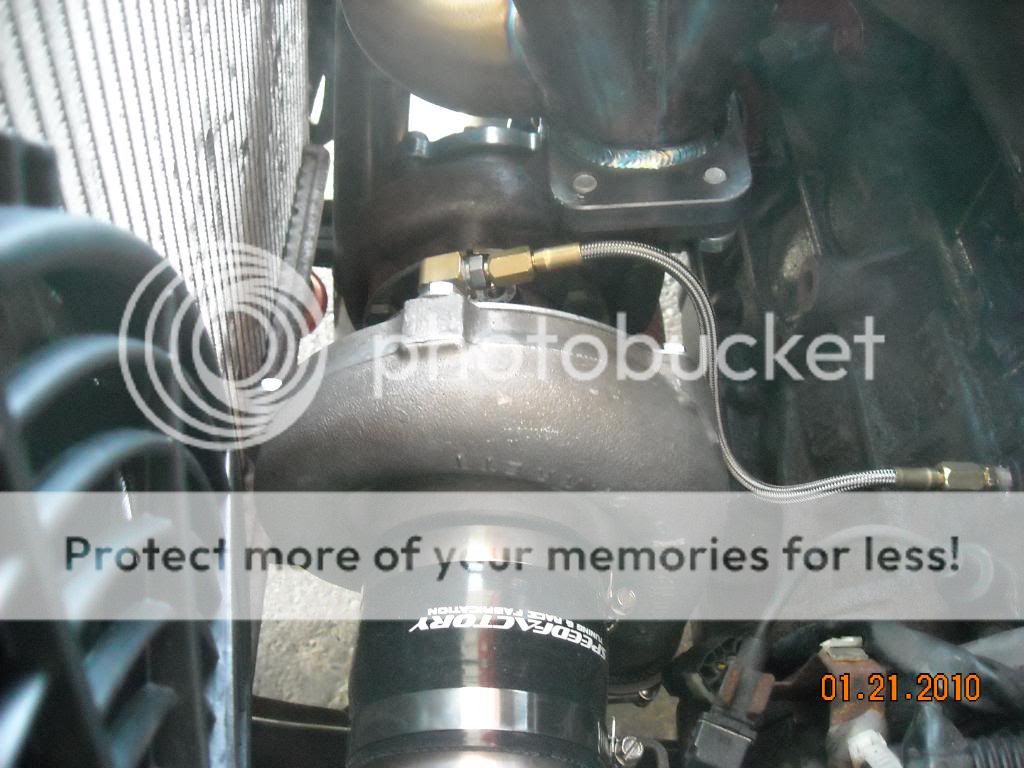

Hey guys My turbo project is done and if you have any questions about cost or if i can remake parts for fellow Tibs I can and Will just ask me! But Pm me ill shoot you price and time to build!
Just a little info on the build,
550cc srt 4 injectors
Custom manifold
2.5 inch down pipe
TiAL Q BOV
TiAL 38mm external wastegate
Aem fic 1910
Custom 2.5 intercooler piping
Garrett T3/T4 50 TRIM .48 AR HOT SIDE
And had to convert to a slim fan and also move the radiator forward about an 1 inch for clearance of the dump tube and TiAL wastegate!

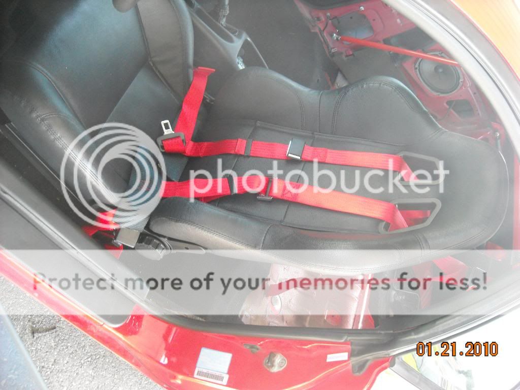

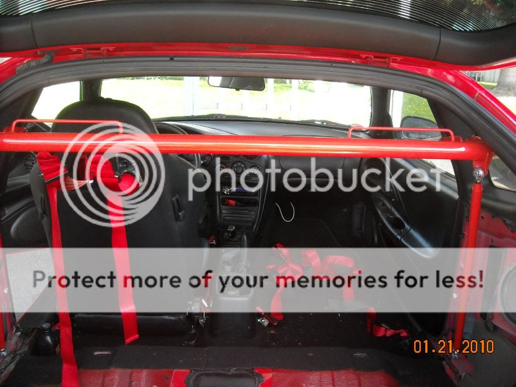

completely SICK. i'm jealous!!! what is that thing on the passenger strut tower? and what are those seats?

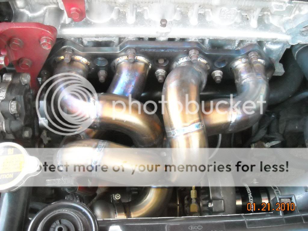

nice! That's a sick manifold.

QUOTE (BayTib13 @ Apr 17 2010, 05:46 PM)
Thanks I call it Crazy Ram, cause it is kinda half ram style half crazy! I get alot of complements on it, and it is nice because I have yet to see another like it!

QUOTE (HyundaiKitCoupe @ Apr 17 2010, 05:00 PM)
The piece coming off the harness bar is just there to add strength to the harness bar, plus it helps with flex. I will take more pics when the interior is done! Thanks for the compliment man!

Nice, did you custom make it?(the manifold)

QUOTE (BayTib13 @ Apr 17 2010, 07:11 PM)
Yep, this is all custom made, the only thing bought was the materials! I had a guy make the Flange off a CNC milling machine! We couldnt find a exhaust flange by its self any where but, we made jigs for all all the stuff so if you want one let me know we can make em, but it not cheap lol. This isnt OBX!
