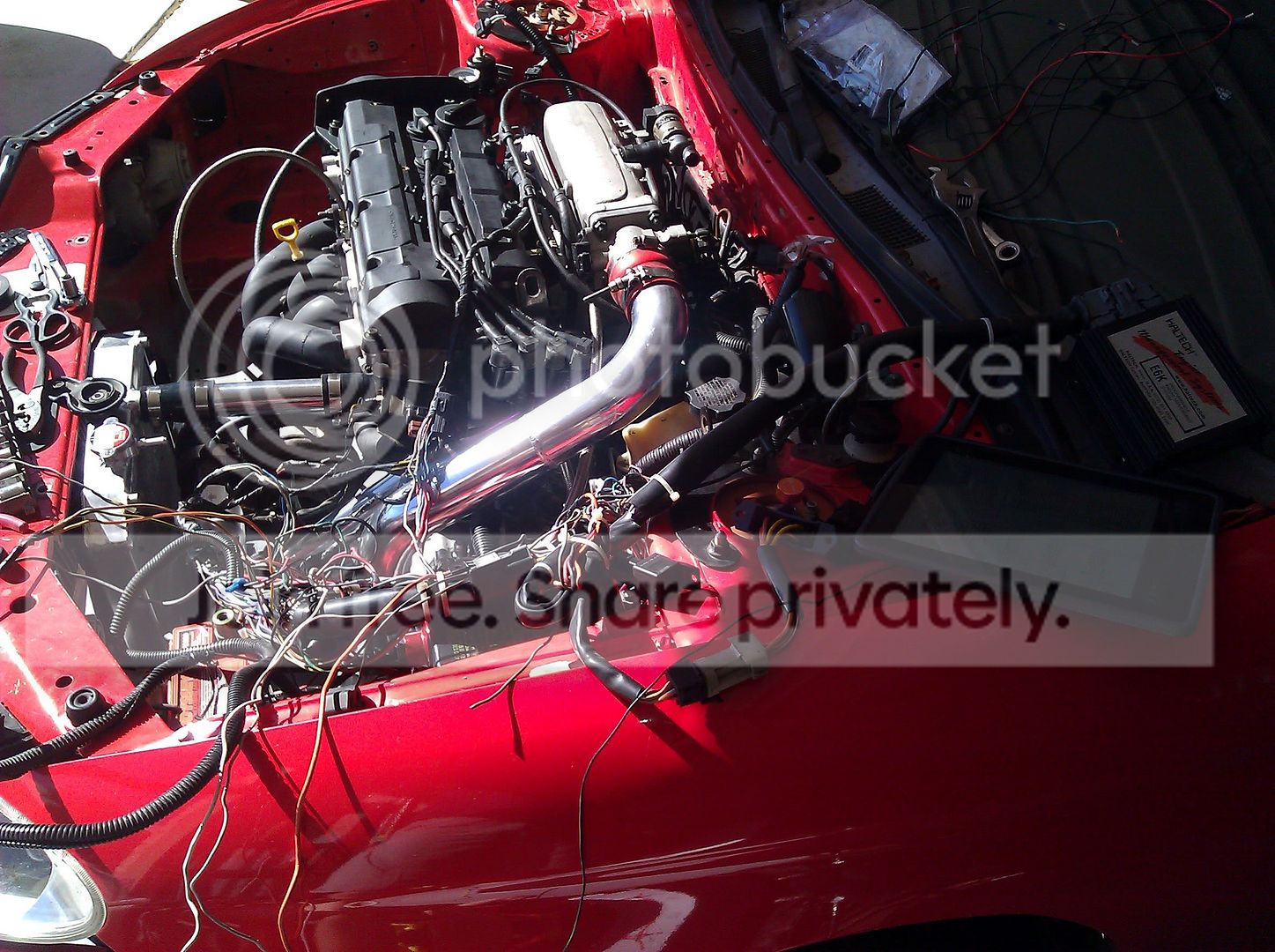

Well, the factory ECU wires are fuxed and I don't remember what the hell I did before. The fuel pump won't come on and I've got 3 wires on the ECU harness side without any loose pins on the connector. wtf? :dunno: So, guess I'll go straight to the Haltech. Other than that, I think I'm good to go.

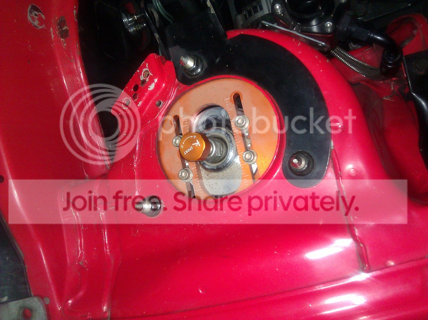

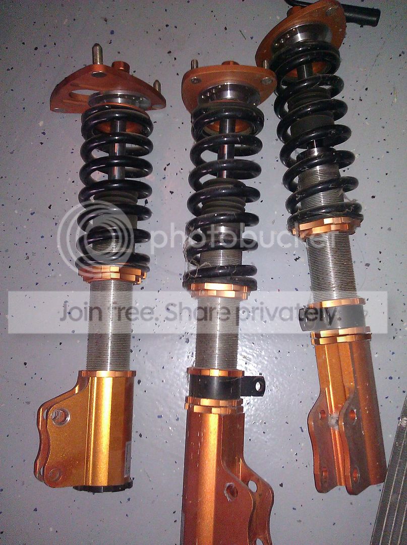

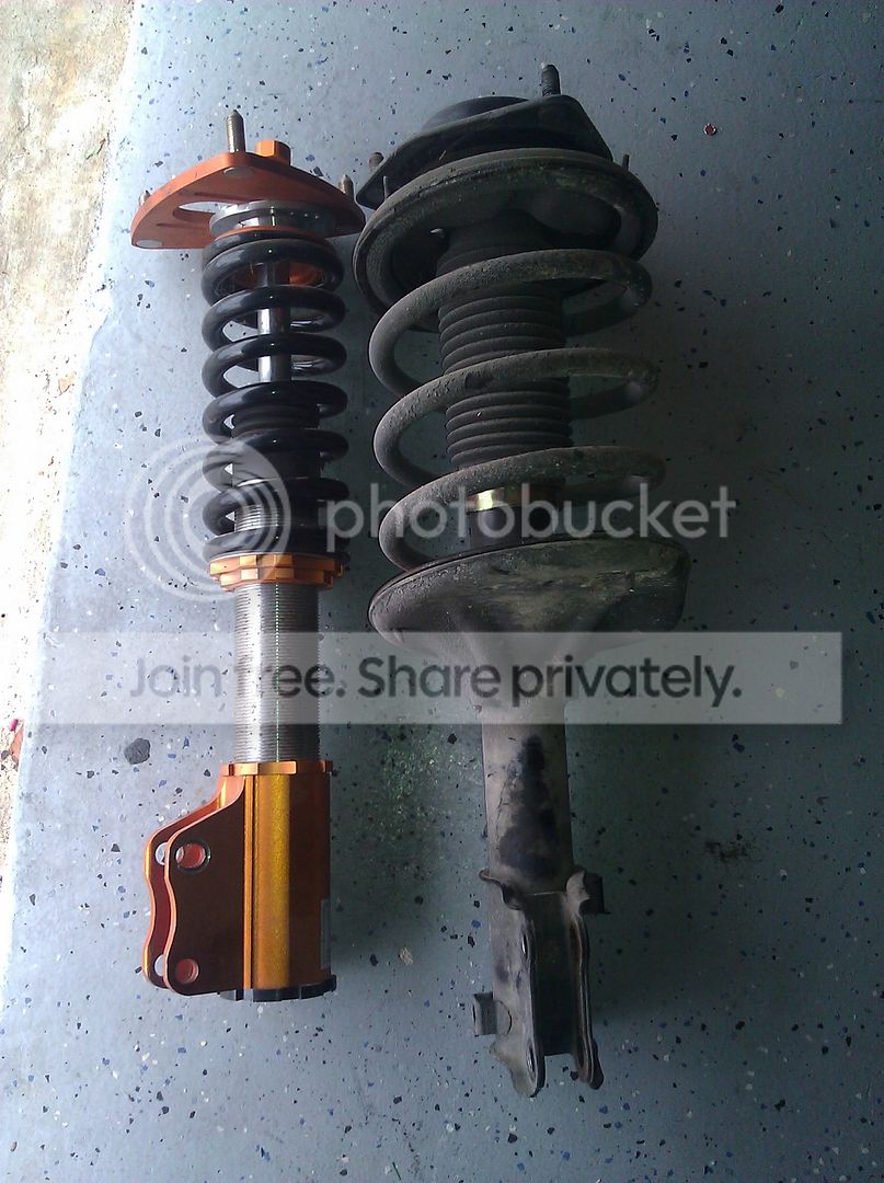

Tim gave me a killer deal on is old Haltech and Ksports:
https://img.photobucket.com/albums/v...ps755fa343.jpg
https://img.photobucket.com/albums/v...ps3ad5064a.jpg
https://img.photobucket.com/albums/v...psdc969afc.jpg
Wiring going ok so far. Hopefully the computer connection will too.
https://img.photobucket.com/albums/v...ps79a0900f.jpg

Check the ground from the tank to chassis, had this prob with my civic,just ran a new ground from the tank to the frame and she powered up....Good score on the coilovers,you'll love em !

It was grounded ok, just not receiving power. Now that I'm installing the Haltech, I'm rerouting the power wire. When I touched it to positive, the pump started right up, meaning it still has the proper ground.

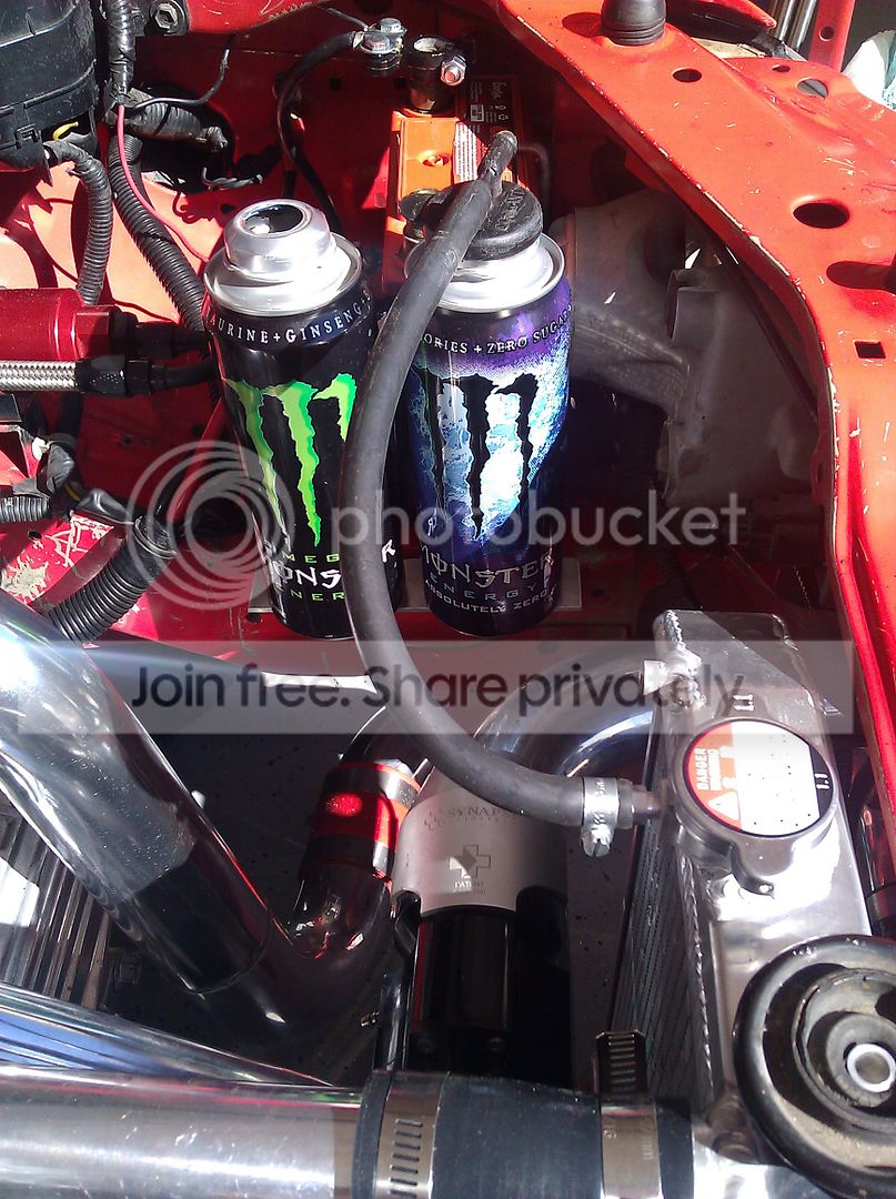

I haven't updated you all on my Monster Energy can upgrade. :biggrin:
Just got done building the aluminum shelf for them. One is the radiator overflow for the new halfcore, and the other is a catchcan that's lacking $120 in AN fittings and hose. It may be a few weeks before I finish that off. Shouldn't need 1" of ventilation quite yet.
Powered By Monster!!!
https://img.photobucket.com/albums/v...ps52423cd8.jpg
