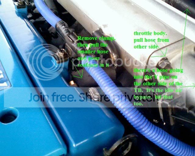

I had Deep Creep which was in a pressurized can so I just sprayed it in, but if you get the can you can go by this (as posted by JH~Tibby):
<div class='quotetop'>QUOTE </div><div class='quotemain'>The vacume line works well but......
1.) Pour the SeaFoam into a spray bottle.
2.) Take off your intake to expose your TB.
3.) Turn your car on and let idle to normal temp.
4.) Spray the TB with it closed, It should make a little puddle in the bottom of the TB.
5.) Suck in the small puddle by pushing the throttle open.
6.) Spray and open the intake at the same time to suck it in. (Spray Several times to get a large amount in.)
7.) If your spay bottle has a stream setting use that a couple times to get a heavy amount deep into the IM.
8.) Complete step 6 untill the bottle is empty.</div>

Ah thanks mate... I wish I had someone around that I could pester them so that they could point and say "okay dummy, thats your BB, over here is your TB, and thats your STE. Don't mix it up with your CEE or you'll be in trouble."
But alas, all I can do ask for help from ya guys heh.
