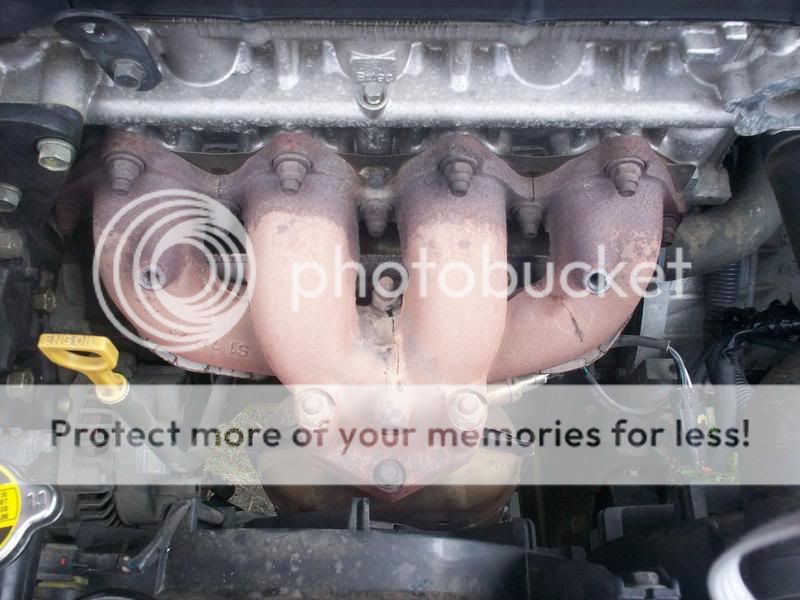

When I removed the heat shield I was surprised to see that my manifold was thoroughly cracked, here are some pics:
Question is: Is it under recall? If it is, should I bother with getting it done and sell off the one they give me? (Or keep it in case I decided to sell the car as stock)

Yep it's definetly been recalled. Why bother getting it replaced though if you're gonna throw on aftermarket headers? Unless you wanna hang on to a stock manifold, I doubt youd be able to sell it but would be go to have if you do sell teh car like you said.
I would have hyundai replace the manifold if its under warranty just so A. I don't have to pay for labor getting the old one off. B. less chance of someone not under a hyundai warranty breaking something that I will in turn fix.
yes you will have the same ole manifold on there when you leave but its nothing to take that one off after they have messed with it. then go home and put on your new one.
just my opinion.

your assuming they would even fix it under recall, they would only supply the manifold for me, but i had to pay for the install.

I'll put the cracked header aside and contact the local (60 mi away) dealership and have em replace it, just so if I want to, I can go back to stock. Since that hasn't been checked, I'll go ahead and have em look at all possible recalls on the car at the same time.

the dealer is the one that wanted to charge for the install. supposedly the recal only covers the part, not the cost to install it. (bullshit)
