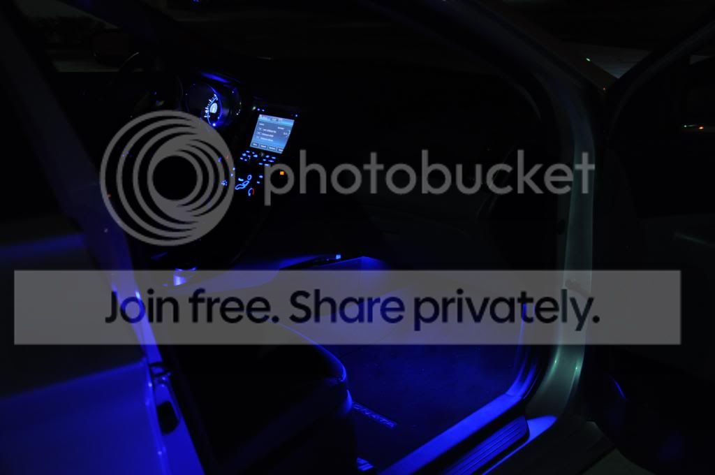

DIY Underdash/Underseats Blue LED Modules
DIY Blue LEDs Cupholder
DIY Custom Blue LED Hyundai Logo in Center Console
DIY Blue LEDs in Glovebox
All Interior Blue LEDs Controlled by a RF Wireless Multi Function Remotes

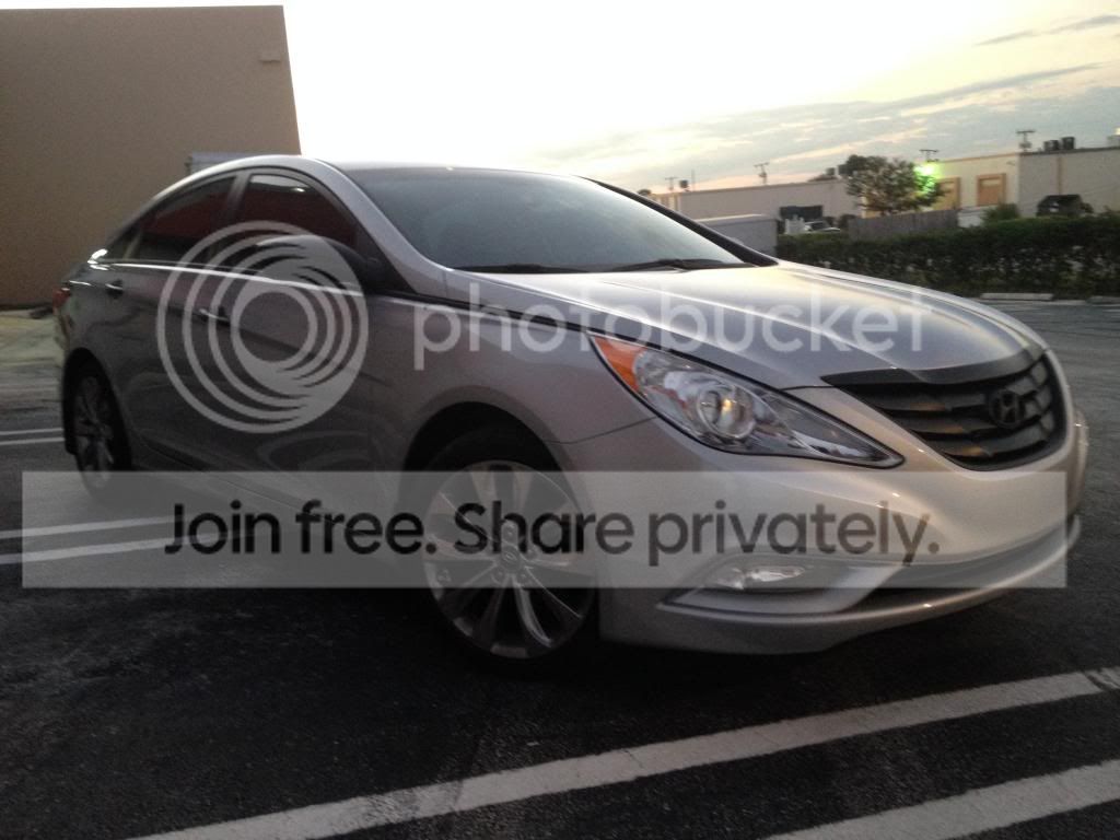

Photo from the dealer the day I picked it up
Outside of my (old) work the next day
Part of the deal/negotiating on price since it was the dealership's Loaner vehicle, I talked them down pretty low and also said I wanted the OEM Spoiler installed, the doorguards removed and pinstripes removed.

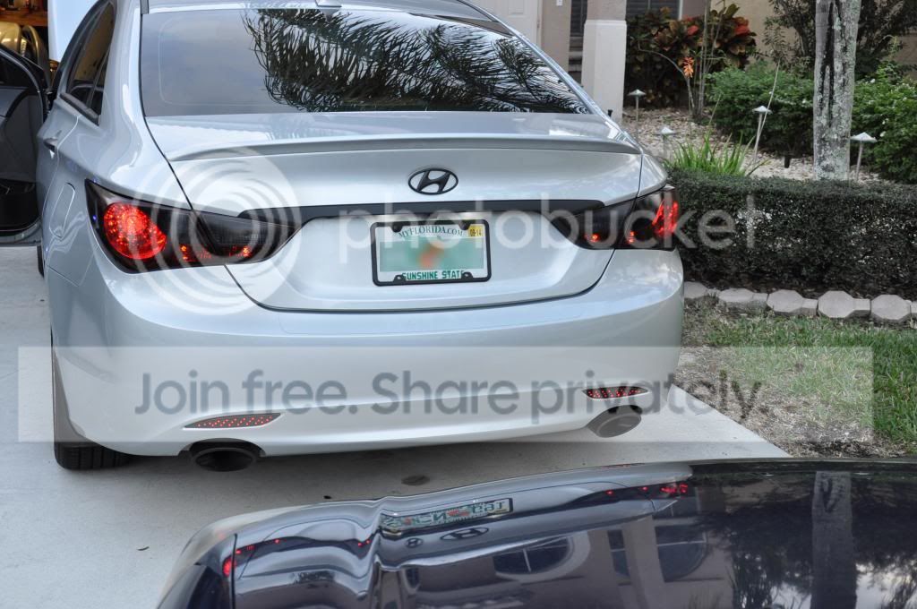

I also re-located the OEM reverse lights to the inner side of the same housing where the rear turn signals are and used a 921 5-LED bulb for lighting.
I installed 60w Headlight bulbs in the existing reverse light location and they are wired to a switch off of ignition on the steering column inside.
The reason I did this (also had it on my last car) is because in Florida we have TONS of idiots that drive with their high beams on at night and are too stupid to realize they are on so I give them a taste of their own medicine. Or if someone decides to ride my @$$ then they get a flash of bright light as well. Yeah, you can hate or like this mod and criticize it all you want but it is what it is.
Stock Reverse Light vs 60w Light
5-LED Reverse Light
"Tailgating" Light On

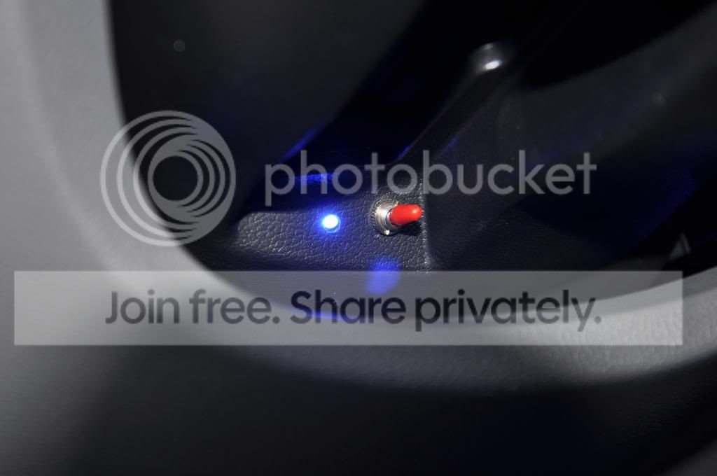

Toggle switch under steering column. (other switches are explained later).
White LED indicator on top of steering column to let me know when they are on or off.

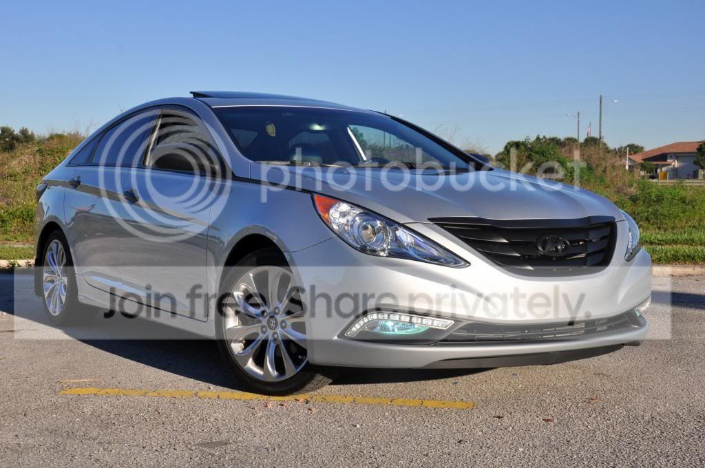

Next was to plastidip the front grill along with the upper hood trim piece.

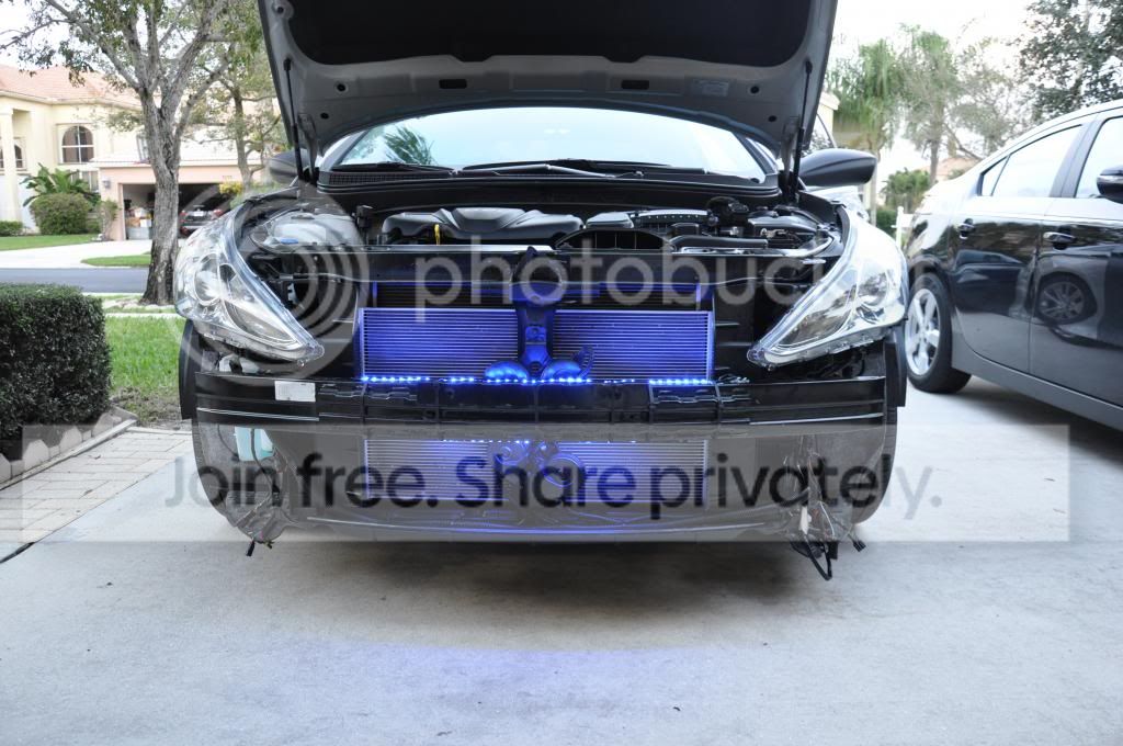

While I had the bumper off I wanted to upgrade/change some of the existing horns. I removed one of the Hyundai horns behind the grill and replaced it with (3) Fiamm Hi-Lo-Lo Horns. The other Hyundai horn below the passenger headlight is still intact. I will post the video later on so you can see the sound difference.
(zipties shown are for another mod installed listed below)

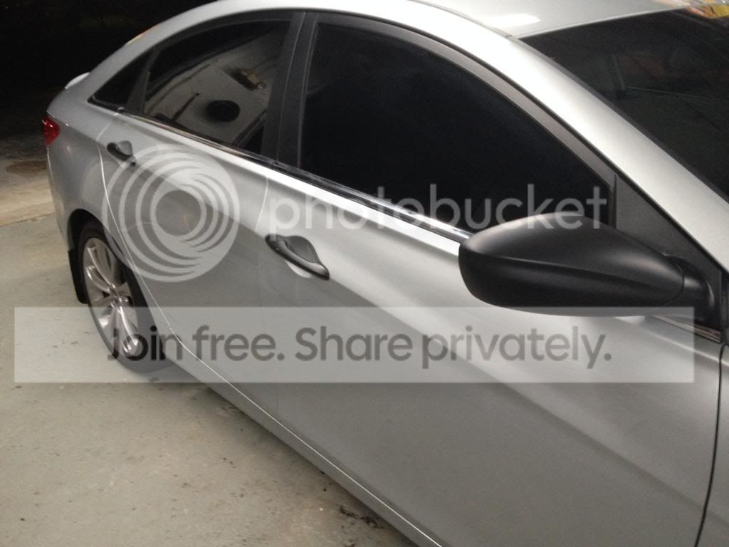

The next thing to plastidip were the chrome handles and the sideview mirrors. I had to do a few photoshops before I did this mod and I am happy with the outcome.
I also had the car tinted. I have 20% on all windows and 50% on the windshield.

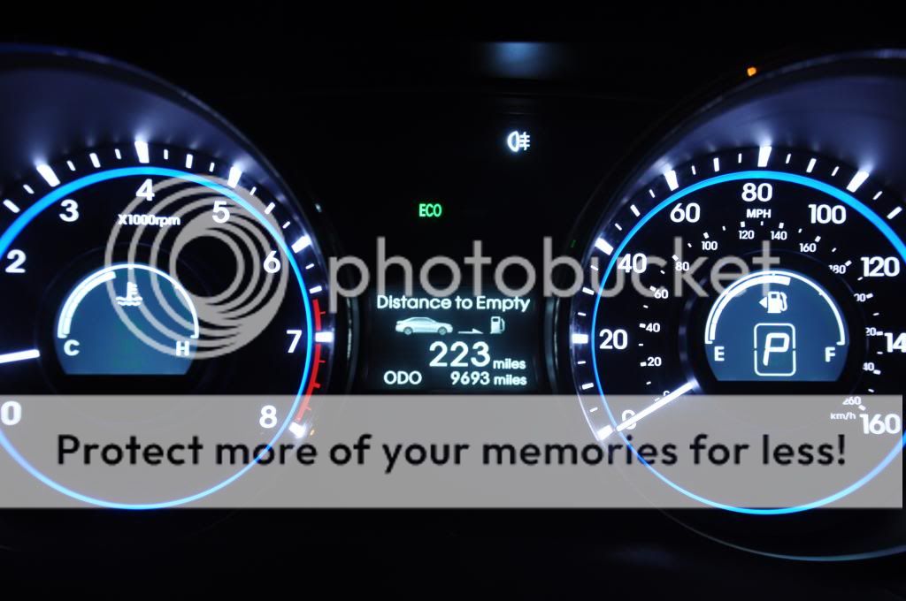

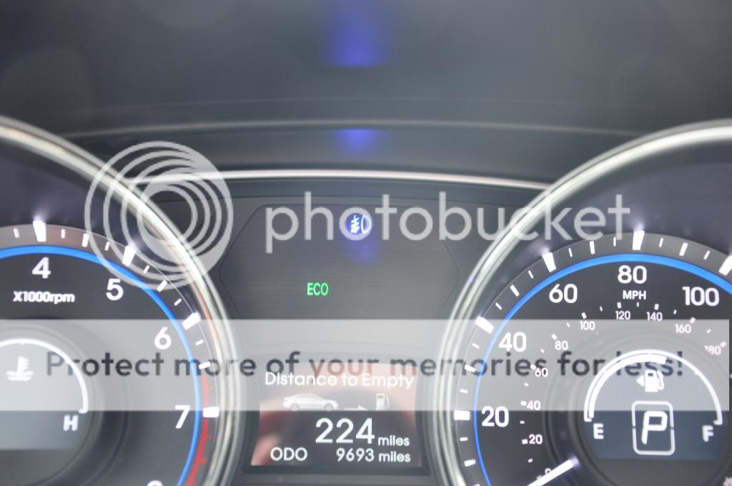

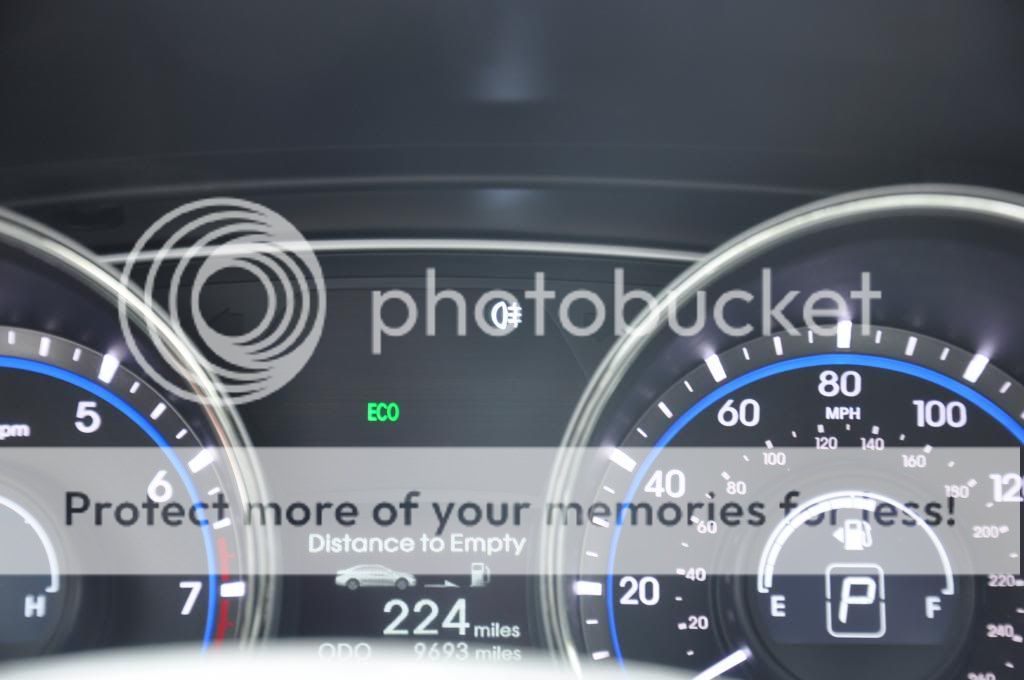

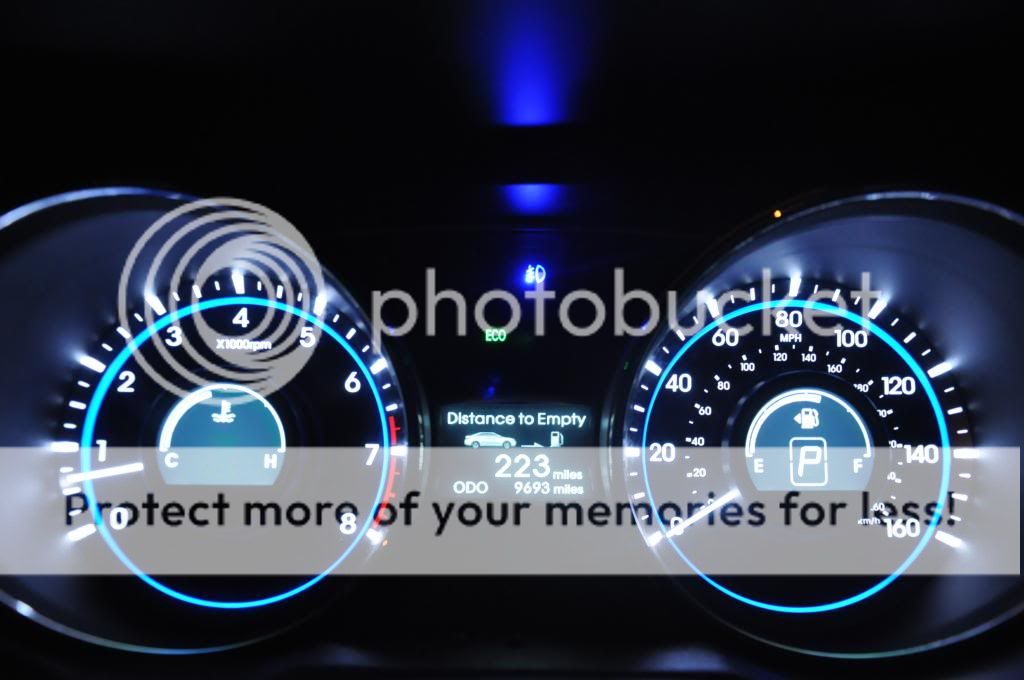

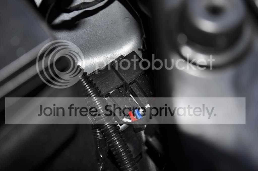

One of the things I most always do in every one of my cars (if it doesn't already have one) is install a constant 12v outlet. The sonata only has ignition 12v outlets so I added another outlet inside the center console and wired it to constant. I found the constant wire in front of the fuse box (thick green wire).

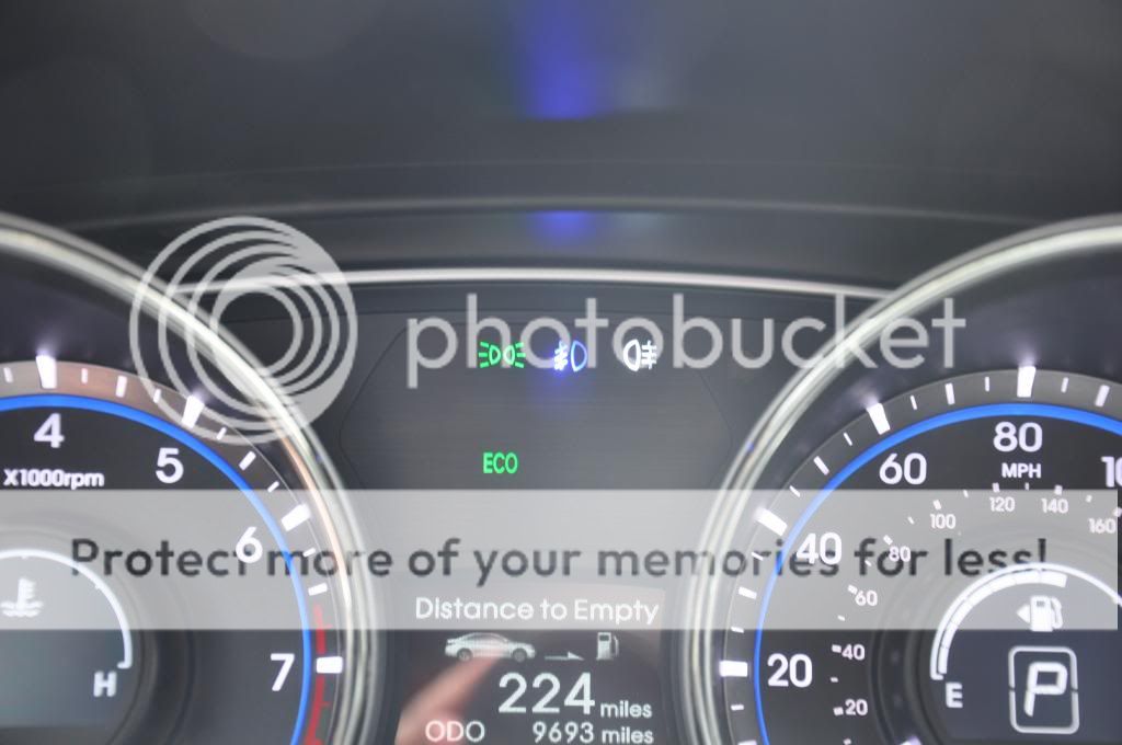

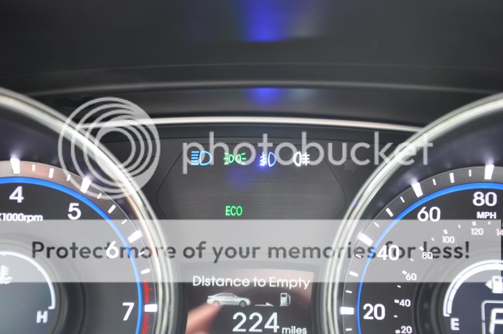

I also did the DIY and wired the foglights to come on with the parking lights. Since there was no way to use the existing OEM switch to turn on & off, I installed a toggle switch under the steering column with a blue led indicator to tell me if they are on or off.
pictured here is the relay for the fogs and the other relay is for another mod explained later

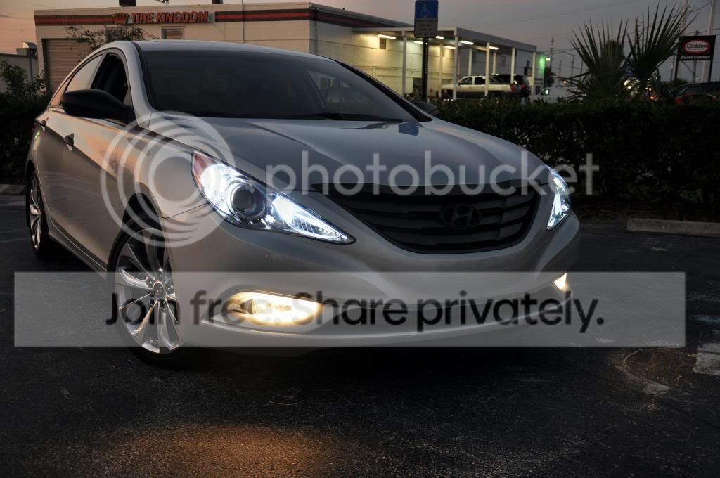

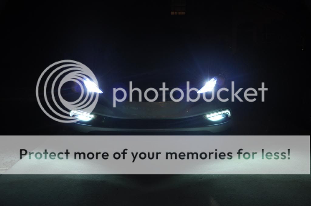

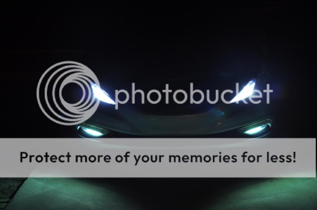

I ordered 2 sets of 6000k HID's from DDM Tuning. 1 for the Lowbeam, 1 for the Fogs. I used relay harnesses for both and have had no issues since I have installed them and I love how they look. While I installed these, I also installed the LED DRL Lights that go above the foglights. I got the ones that also have the turn signal indicator. I also installed switchback LEDs (amber/xenon white) for my front parking lights/turn signals. They have resistors installed on them so I have no hyper blink. For the factory DRL lights I installed xenon white CREE LEDs. License plate lights are also Xenon white LEDs.
{these photos show the wiring install and where my ballasts are mounted}
both relays mounted

The next mod was to finish off the interior lighting to complete the blue theme. I'm so glad that Hyundai stuck with their blue lighting. I did a similar mod on my wife's tiburon since it came with OEM blue lighting too. I installed (4) 50/50 LED strips that come multicolor, but I only soldered wiring on to the strips to make them light only blue. They are installed under each front seat and under the dashboard. I also did my own DIY LED cupholder since I have done this in every car of mine as well. I used some more of the ebay 5mm blue leds and installed a total of 4 led's for the cupholder. All of these lights are turned on once the parking lights turn on. I have a toggle switch installed in between so if I want to turn them off I can. I also ordered a 12v RF wireless remote that lets me change patterns, speeds and adjust brightness for all of the added blue lighting I installed.
100% Brightness
50% Brightness
25% Brightness
I also installed a 2" 50/50 LED strip wired to blue for the glovebox lighting and removed the small 194 bulb.

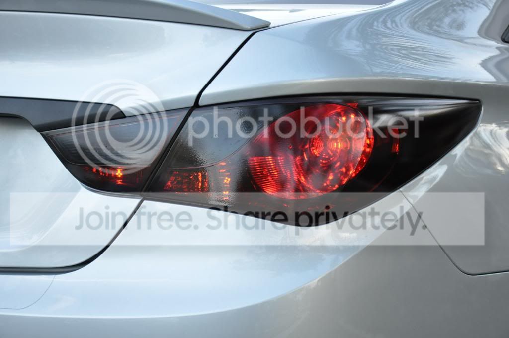

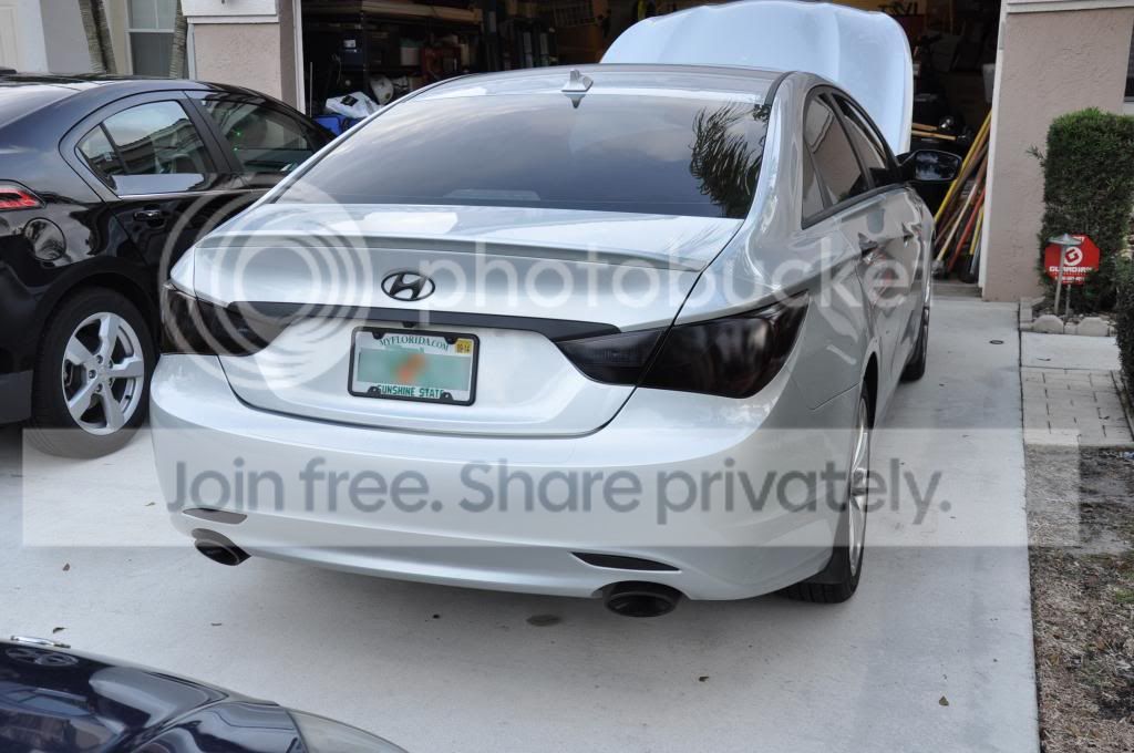

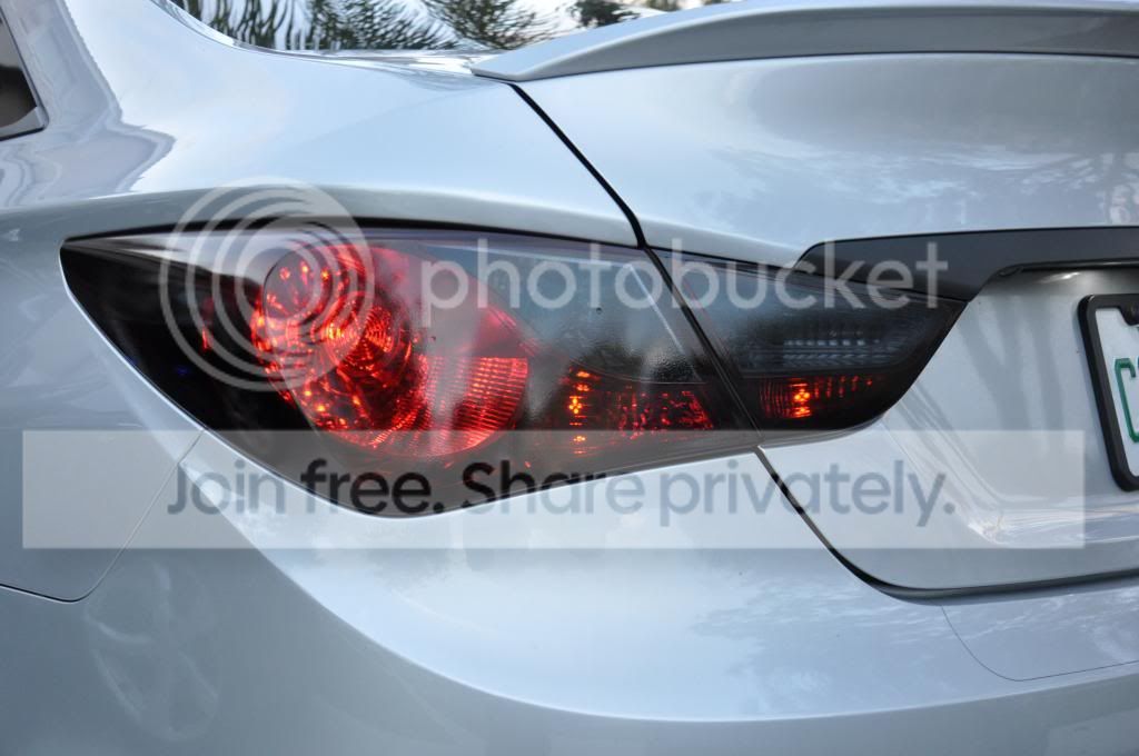

Since my local tint guy was giving me a hassle as far as tinting my taillights and starting to aggravate me, he lost my business. For now I went ahead and bought modelmasters transparent black spray paint and did my taillights myself. The outcome isn't perfect but I am happy with it. It did leave a few "bubble" looking spots and I ordered just enough cans. These cans are the ones that are very small and can be found at local hobby/RC shops.

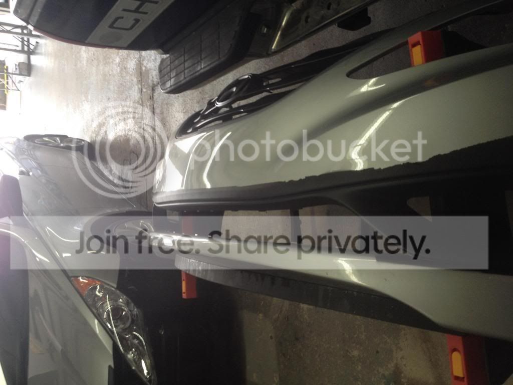

I also ordered the rear bumper LED reflector replacements and I tinted those too. They are some cheaper ones on ebay but I plan to do different lighting later on. The LED bumper lights are wired to the parking lights and brake lights. There will be a video showing the brightness of these as well as the taillights. Installed but not pictured are Red LED Turn signals.
One of the most recent mods I did was with the last strips I had left of the 50/50 LED strips I installed on the actual bumper support to light up the grill/lower valance at night. The strips are siliconed in and the zipties were there to apply pressure and to seal them down and I ended up just leaving them on since they are black and you don't see them. The lights are wired to constant so I can turn them on with the car off. They will soon be wired in with another 12v RF Remote so I can do different patterns and modes with them. I also installed a blue LED indicator light on top of the steering column so I know if the light is on or off. I don't drive with these lights on at night.

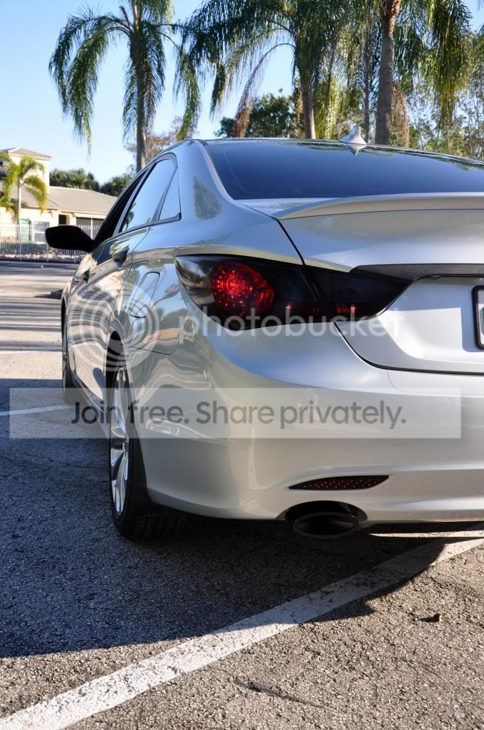

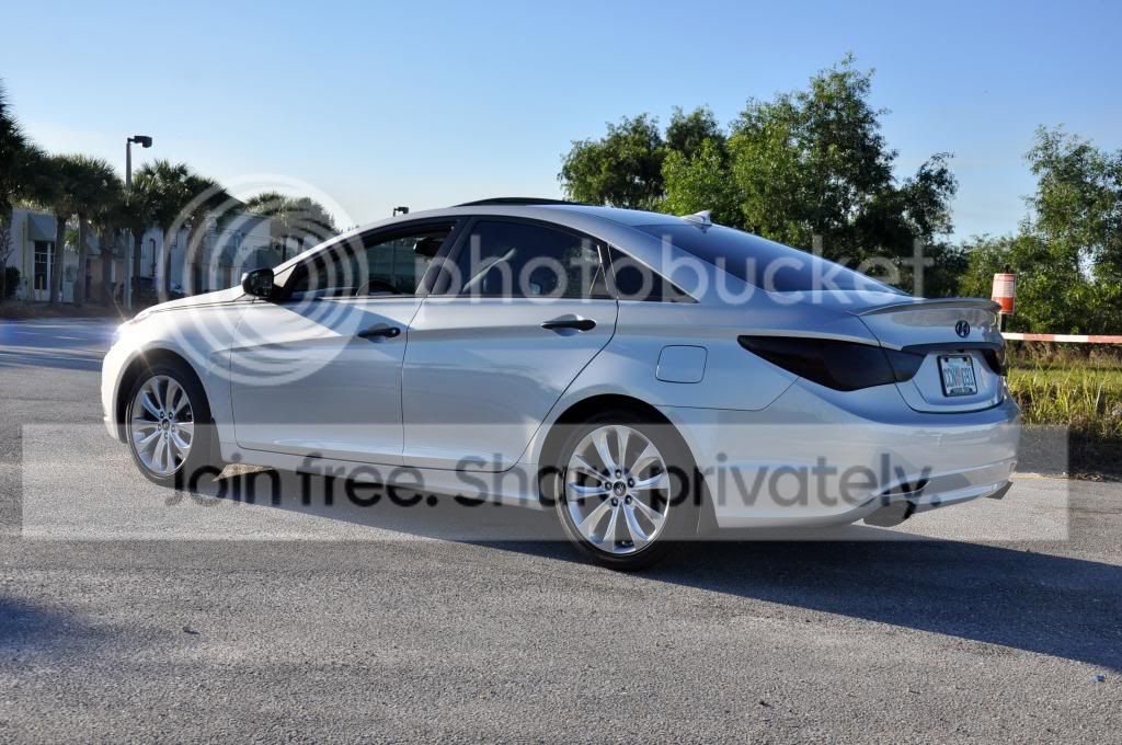

Here is how she stands as of 2/27/14!

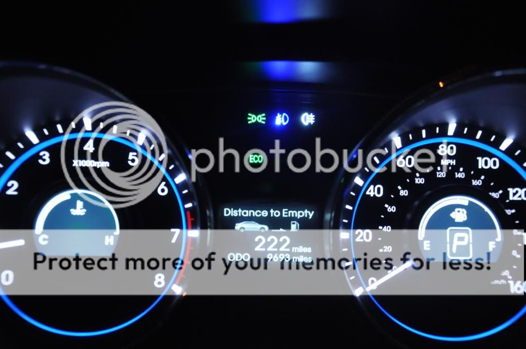

Changed the DIY Foglight Wiring to be able to turn on the fogs anytime the car is on (before it was wired to when the parking lights were on)

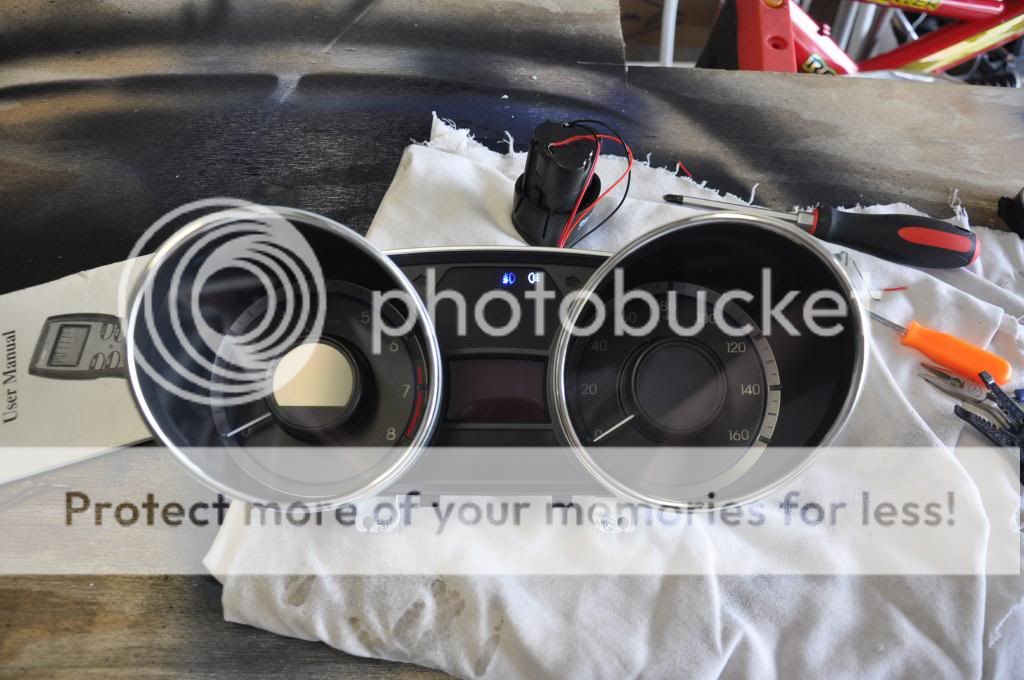

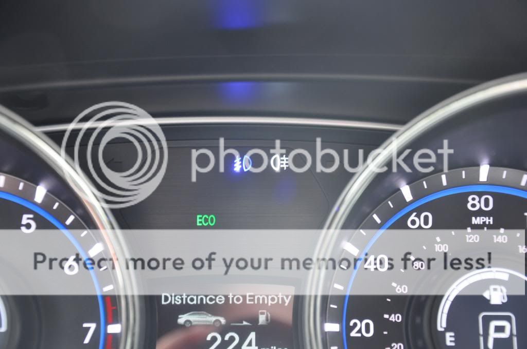

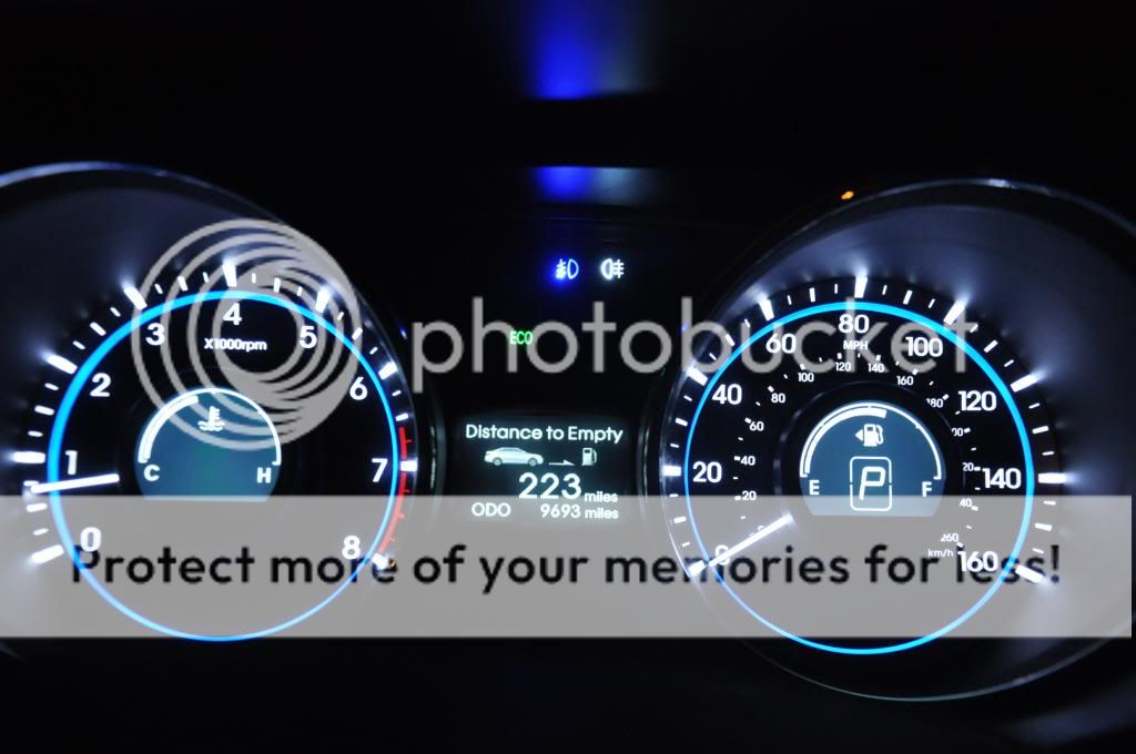

DIY Custom Blue LED Foglight Indicator in OEM Location on Gauge Cluster
DIY Custom White LED - DRL LED Indicator in OEM Location on Gauge Cluster
I wanted something more 'custom' and a better oem look than the led indicators I had drilled holes for. I know you're saying "well now you have empty holes!" I actually never had an indicator light for the DRL LEDs so there wasn't a hole. As far as the LED that was lit up when the fogs were on, the LED is still in the hole and I left slack on the wires. I'm sure I'll end up using that blue LED as an indicator for something else down the road. All I did for these OEM type indicators was I pulled out the gauge cluster again and I removed both the front & rear plastic pieces. I also unscrewed the (4) phillips screws from the circuit board but did NOT remove the board. There was enough play to wedge both wires through the holes once you remove the plastic piece (as seen in my DIY Disable Seatbelt Flashing Indicator thread). You'll notice that the far right indicator doesn't even have an LED. This is for the Korean version of our cars that has a 'foglight' on the rear bumper. I used a little bit of black electrical tape around the 5mm led to let it sit in place so it would beam out straight. I extended the pos/neg wires on both led's and ran them to the switches I already had mounted for the foglights and DRLs. I only had to shave down a little bit of a corner of the white plastic trim piece in order to get the wires out and to get the clip clipped in.
I'm very happy with the outcome. I took a quick drive just now to make sure the lights were aiming in my face and they are not at all. I'm so glad I did this mod!
Here you can see I am testing the LEDs with a regular 12v battery from my drill
These are how the indicators look during the day:
The white indicator is for my DRL LEDs
The blue indicator is for my HID fogs
Both indicators on:
With headlights on

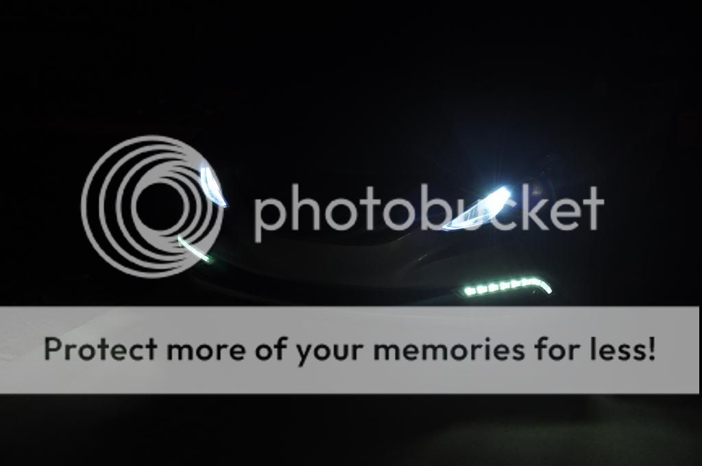

With high beams on
At night
Both on at night
With headlights
With high beams

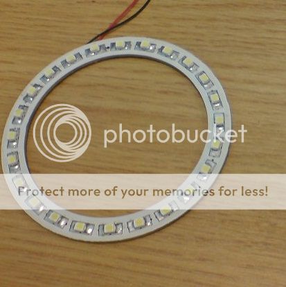

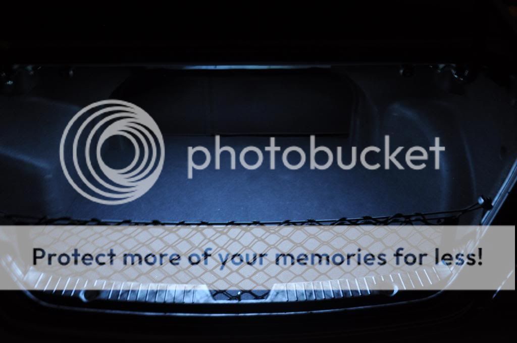

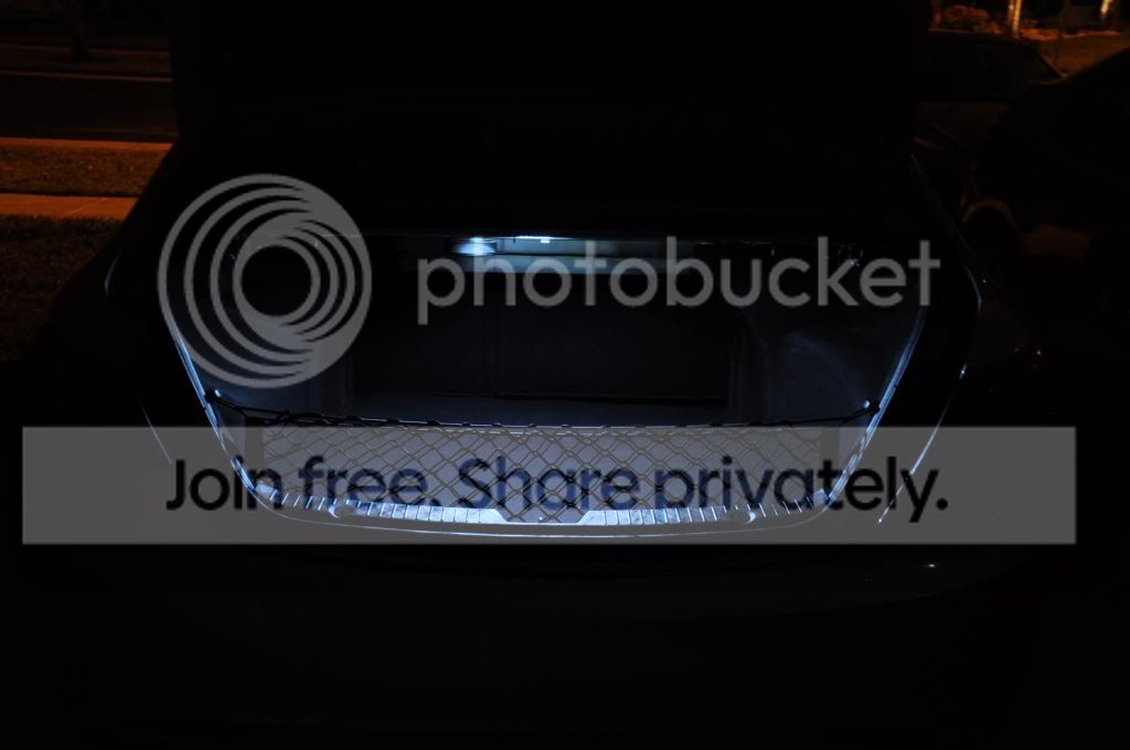

This is the type of LED ring I used for the trunk. You would think it would only beam down straight but it does not. These are wide angle type LEDs so they light up the trunk brighter than any standard LED replacement for the trunk light bulb will!
Excuse the camera glare!
Brightness

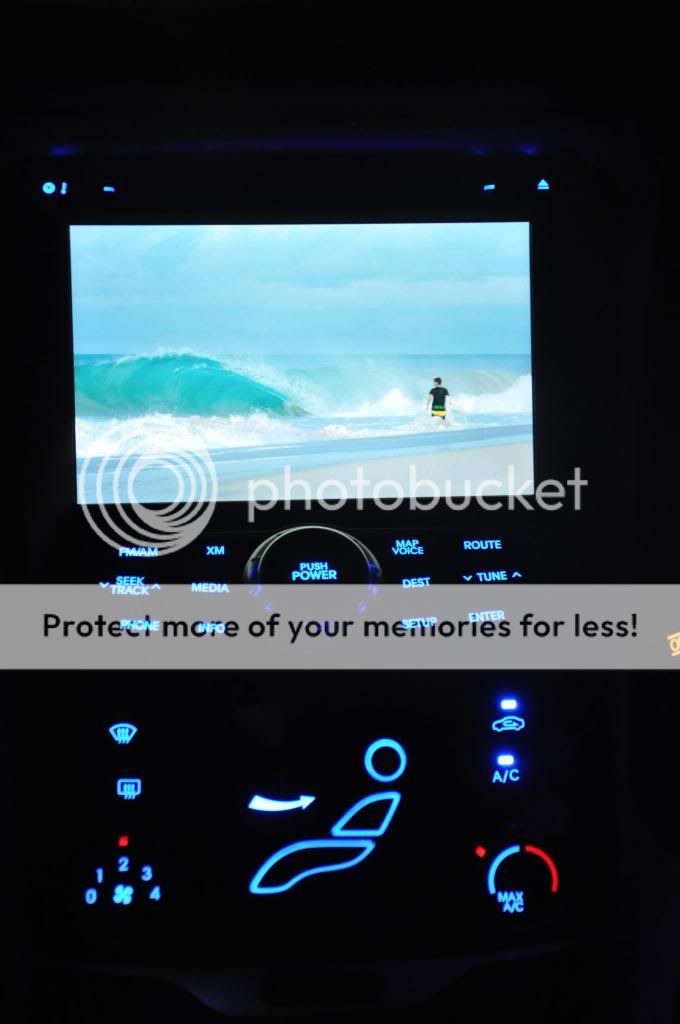

Last but not least I added a photo on my nav screen for when/if I ever shut off my radio for what so ever reason lol
