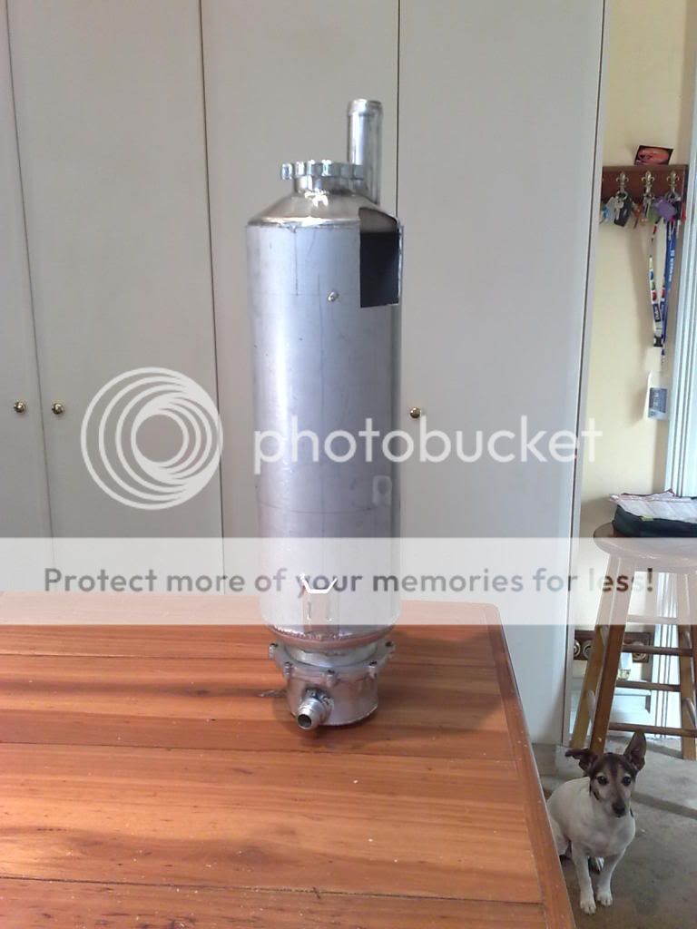

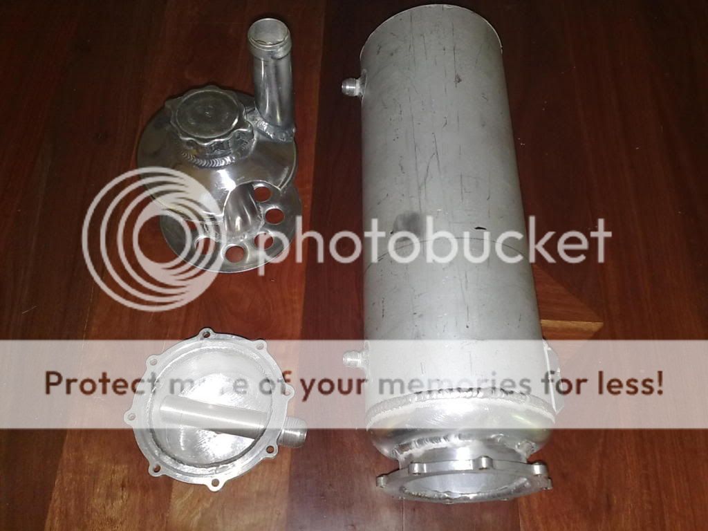

Started working on the dry sump tank, only have a fairly small area to work in so it the radius had to be rather small which isn't bad. I reluctantly cut up a Peterson tank to get some ideas, to be honest they are a very basic cheap tank. Back to square one. Even more reluctantly i cut up a "roush" sprint cup tank, we hit an all new ball game. What an amazing tank inside. So that is the base plans for the hyundai's tank.

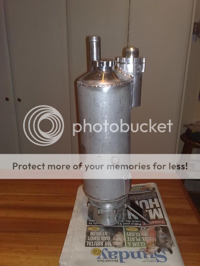

Tank is nearly done, just need to put a few more fittings on.
