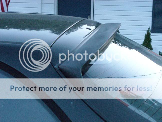

Thought I'd post my project over here as well.
Last summer I started working on this. Originally I was gonna have 2 lip design, but then opted for the single.
This is how it turned out...

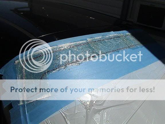

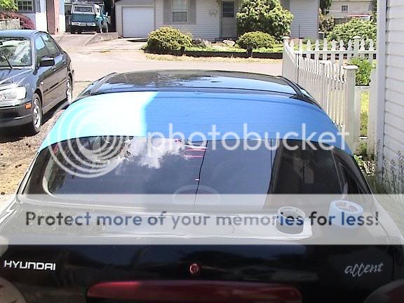

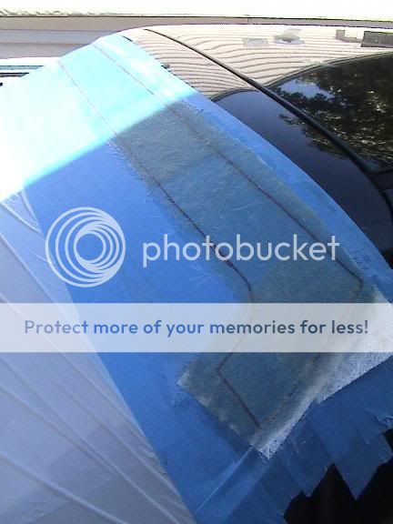

I taped off the window and outlined my design with red sharpie pen. This red outline will transfer to the FG after curing giving me the perfect cutting lines.

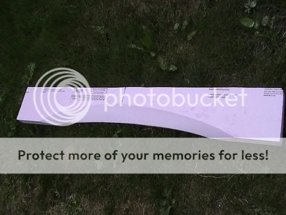

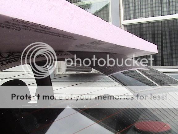

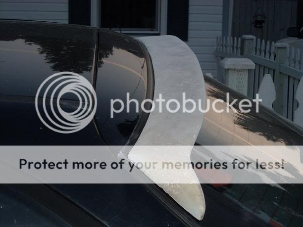

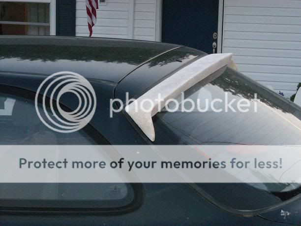

Then I started carving from foam the basic shape of the lip. test fitting the copntour...

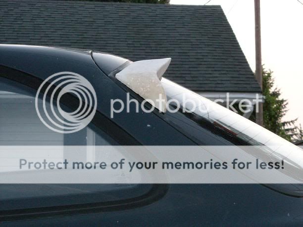

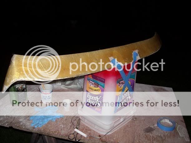

Once I go my final shape I started glassing it....
Did some test fitting again before I did any major filling.....

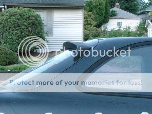

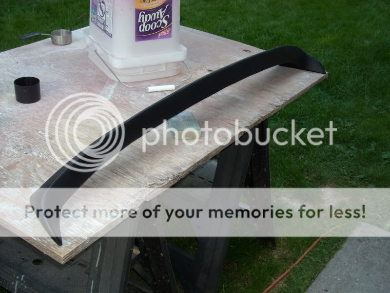

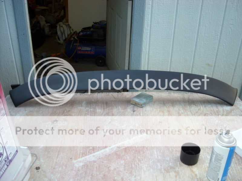

After I was happy with the many layers and sanding of the filler....I could start painting it....for now its just flat black...

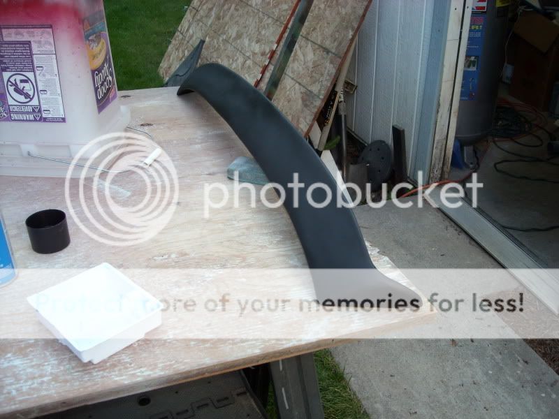

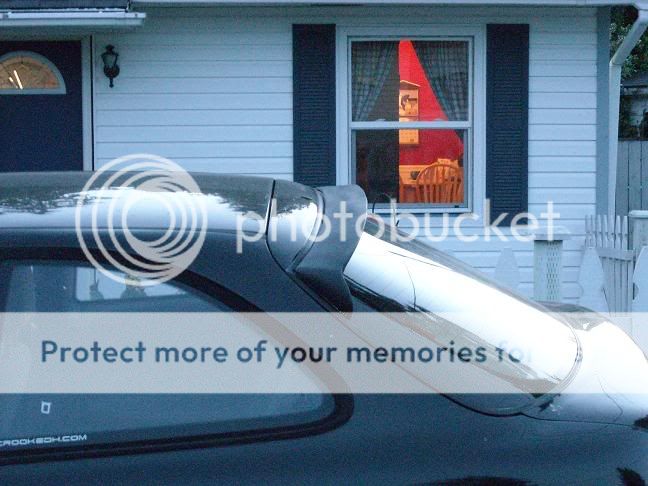

And yesterday I was able to get it on the car. Using 2 side 3M mounting tape which is Indoor / Outdoor grade, should hold nicely...
I figured since there is not a lot of aftermarket support for the 95-99 Accent, thought I'd do my own custom parts. cool.gif
Thanks for looking.

He used 3M double sided tape. One side to the spoiler, the other side to the hatch glass.
It does look pretty bad ass. Congrats on building parts yourself. smile.gif Just be careful because even with the 3M, if you go above 75-80 MPH, the spoiler will fly off. I've gone through 3 different SR spoilers that attach the same exact way. The final one I had, I ditched the 3M, and used epoxy instead. It still didnt hold, and it flew off hitting a PT Cruiser behind me. blink.gif laugh.gif
The only one that are 100% guaranteed not to fly off, are the ATH ones, because they actually screw into the hatch, instead of using double sided tape. Hopefully yours stays on a little longer than most peoples though. smile.gif
I would recommend using a mixture of 3M trim adhesive and Gorilla Glue in alternating strips. Then it will be a permanent part of the car.

So far its stayed on pretty good. I keep checking the mirrors. But I've had it on now about 2 days with long commutes. Avg. speed is about 60-70, depending. Mainly about 60. I have a total of 12 strips of 1" mounting tape on the wing. I cut them to avg. 6" lengths to get around the curves. but I figured using the 1" would be better than 1/2" or 1/4" tape. But has stayed on nicely and still feels secure, even with the warm weather we are having now.

As for the foam, it is the pink foam insulation you can get from Home Depot. I used 2" and 1" to get a 3" workable shape. I also cut the foam into blocks to help with the contour a little. I did it while it was on the car so I could see the shape as I was sculpting it for best angle off the roof for air flow.
Because it is pink foam and using the poly fiberglass resin you have to put some kind of protective barrier on the foam or the resin will EAT the foam. You could also, assuming the car gets taped up well, Can use the GREAT STUFF spray foam. It'll take a few cans, and play with it to keep shape, so recommend slow buildup. the poly resin won't eat the GREAT STUFF. I would suggest going with the epoxy fiberglass resin. It also won't or should not eat the foam. A little more on the spendy side, but also will be a little strong finished product too.
