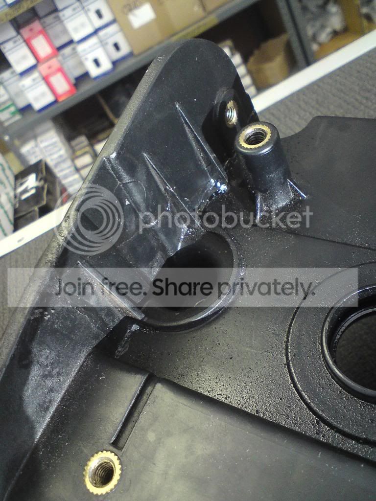

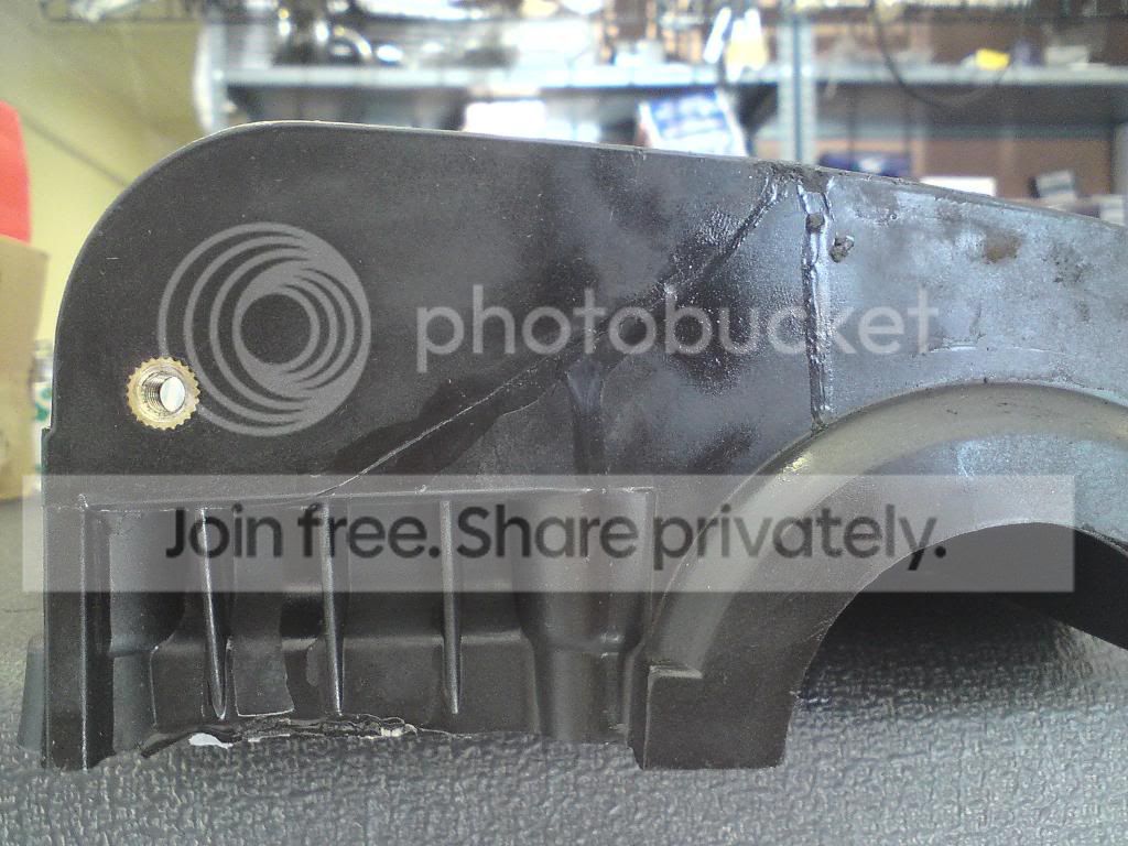

Some pics of tappet cover that was replace.
It was done by me with no sweat.

The crack was not there.
It only happened after the car overheated.
I couldve just left the rocker cover but i had in stock so i just replaced it and didnt want it to leak later
The smoke had a smell like it was oil...
Maybe leaked out of the rocker cover onto the hot block creating smoke.
Thats all i can think of....
