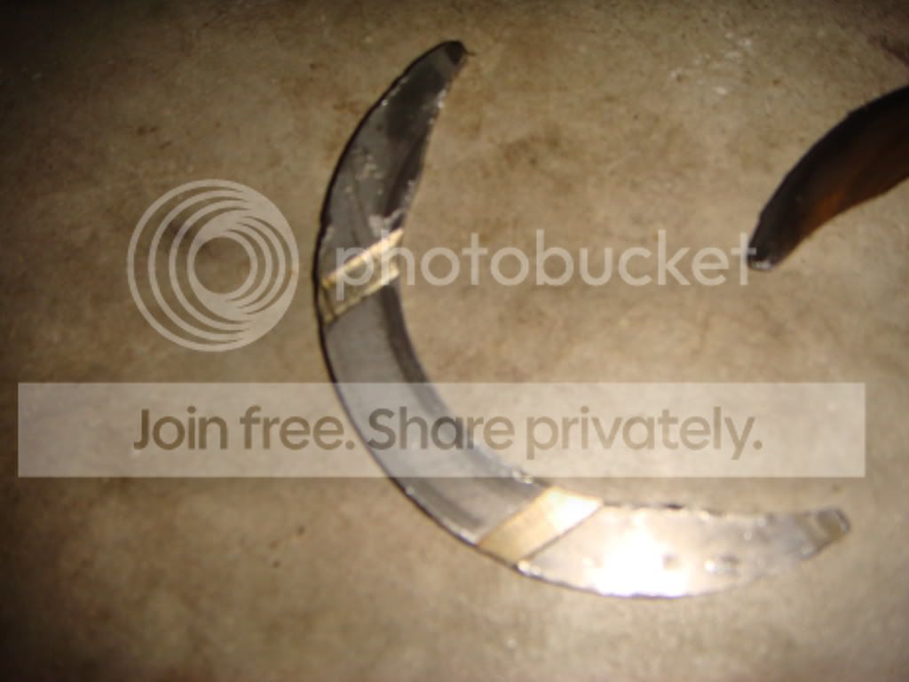

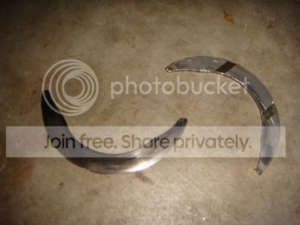

Well I finally caved and dropped the oil pan last night. Here's what I found:
These little buggers were just hangin out at the bottom of the oil pan. Oh well. I was worried about this for awhile. Shoulda checked it sooner. Anyways, just figured I should update this thread with my findings.
Thanks for the help anyways guys. And on a side note, look for a mighty crazy for sale thread soon! fing02.gif
