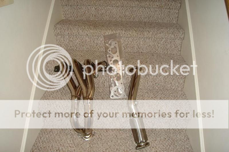

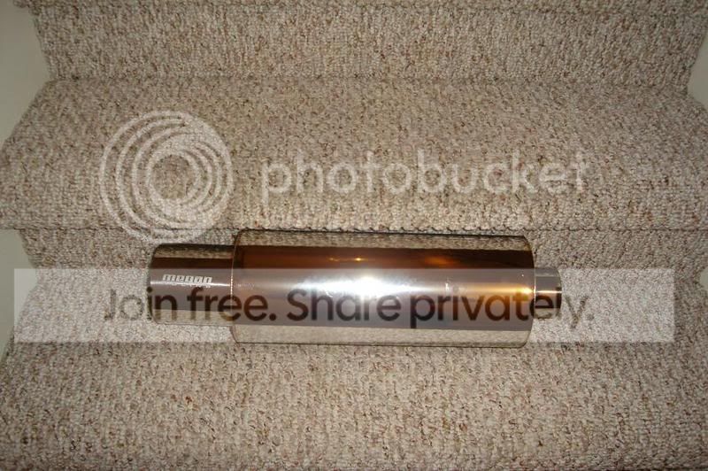

so tomorrow, i need to call like, three shops to see if they can do mandrel bends, and if so. how much. SOCKS recommended a resonator, what do you think?
so i got 490$ i need
1. aluminized 2.5' tubing for the under axel.
2. header install (if its a decent price)
3. 02 sensor lengthened to be placed behind the cat
4. muffler and cat welded
5. mandrel bends

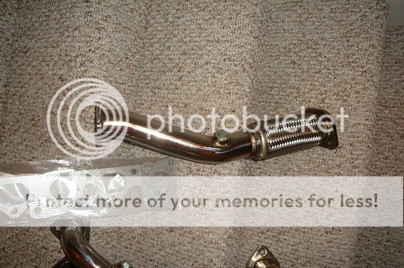

will it be enuf? if so, what is a decent price(please state with or without header install) and have SSautochrome fixed the flex pipe clearance problem yet?

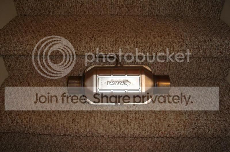

the Catco Cat

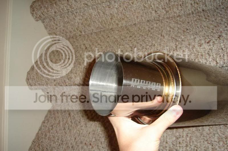

The Megan Racing muffler

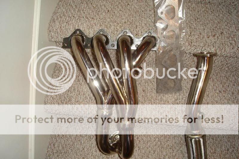

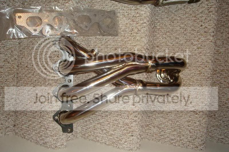

The SSautochrome 4-2-1 setup

I got my entire exhaust installed for $315 at Meineke. I didnt have my own exhaust though, they custom made it and the price included a new cat as well. They did a real nice job on it..so Id recommend them. I know they weld just about anything as well.
Midas is good too..Alex got his exhaust done there (and my dad worked at midas as well so I know their not bad). I dont think they do mandrel bending though..youd have to find out.

yeah, im looking pretty much for mandrel. not crimp bends. what other bends are there that wont restrict flow too much?

As far as funds go, I think that you will be just fine with $490 considering you already have the major parts of the system. A resonator may be a good option to reduce the "buzzy" header sound. There is also something called a "blank" that reduces the header buzz. Ask whoever will be installing the system and get their opinion.
I'm running 2.5inch crush/press bent, whatever you want to call it. The piping was $120 installed, mild steel. Other places I talked to wanted $290 for stainless steel press and over $400 for mandrel bent stainless steel.
It really depends on the machine, but my press bends go down ~0.15-0.2 inches in the bends, which isn't bad, not enough to make a difference on a street car. Personally I'd go to a shop and ask to see what one of their press bends looks like. If its not horrendous then I'd do it there and save cash for something more useful.
And yes, with the headers, I'd recommend a resonator.

press/crush bends will be completely fine for any setup really.. just get them with aluminized steel.. you will pay like 150$ max for the piping.. if you go with stainless you will at least double the price.. if you go with mandrel and stainless you will triple the price..
also, YES YES YES YES on the resonator.. with those headers a resonator is imperitive... seriously..
you will also save on piping when you get a resonator.. i recommend a 30" resonator..
yes i just put that header on two days ago and buzz is driving me crazy. i have a 27" resonator that i'm going to have welded in on my next day off. its so rice as it sits, unless u want people to thing your representing mexico then you might wanna go grab one.
