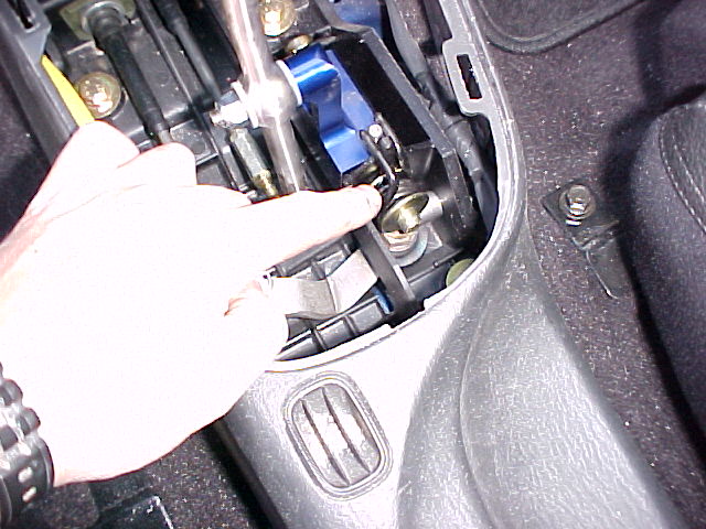

5) Remove the shift cable retaining clip. You do not need to remove the clips from both cables, only the one shown here.
6) Remove the cable from the shifter assembly.

17) Re-install the return spring onto the shaft. The correct order is: washer, bushing, spring, bushing, washer. If the bushings are worn, you’ll need to get new ones from your local Hyundai dealer. Be sure the “arms” of the spring are around both pins, as shown above.
