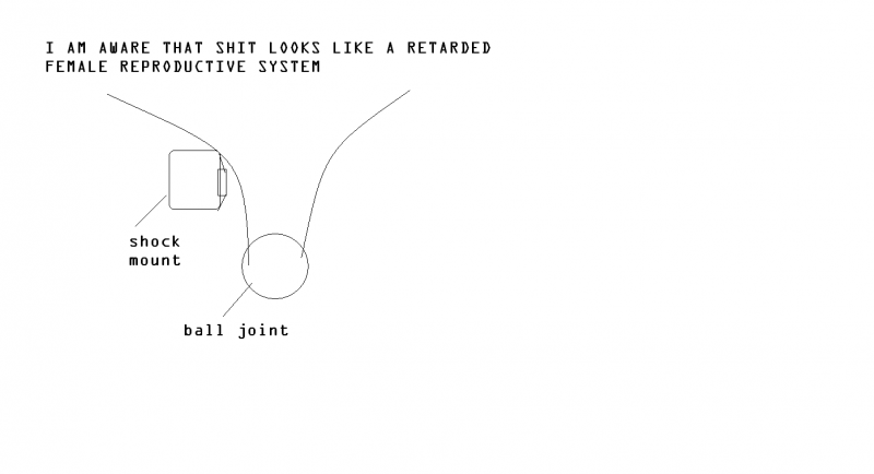

move on to shock 2, break 3/8" kobalt ratchet attemping shock 2, dont have a 19mm in 1/2" so i head to lowes, pick up 19mm and a replacement ratchet, head back home, take tire off, find out that tab on control arm is busted, cuss A LOT
heres a awesome pic, explanation to follow
http://img.photobucket.com/albums/10...ps72be51e8.png
well basically, in order to speed up installation, nissan decided to weld a plate to locate the lower shock nut to the frame, well, because minnesota, rust f*cked up the weld and now the nut is being hidden by said plate
